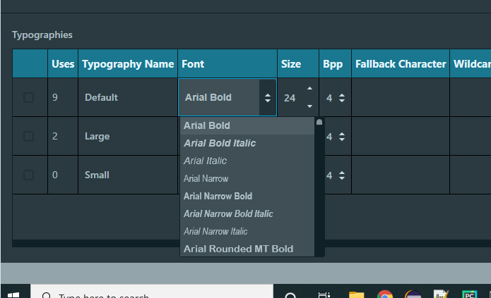

Displaying mix of Chinses and English character
I want to display mixture of Chinses and English character but unable to correct find font in toughgfx.
For example utf-8 encoding E4 BD A0 E5 A5 BD 20 43 68 61 6E 64 61 6E 21 is 你好 Chandan!
Please let me know which font should I select at touchgfx.
Thanks

Microsoft YaHei or MHei, Segoe UI Symbol is some of these in default system fonts.
You can discover fonts by pasting your characters in Microsoft Paint text.
You can also combine and create your own fonts using e.g. FontForge.

I am using UTF-8 format but I think toughgfx use UTF-16. Please clear it.
E4 BD A0 E5 A5 BD 20 43 68 61 6E 64 61 6E 21 IS utf-8 encoded but its not working.
