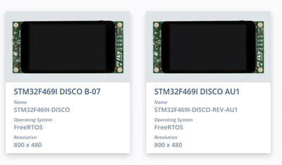

tizdipietro
Also, make sure the project is set up for the correct version of the DISCO board. The one you are using is the new version (can be easily identified as it has the black microphones, whereas the old one had silver microphones U1 and U2). If you start from touchGFX, they are differentiated as B-07 (old) and AU1 (new - the one you have) see picture below. I have both of them, and the projects set up for one do not work for the other board if they use graphics.
