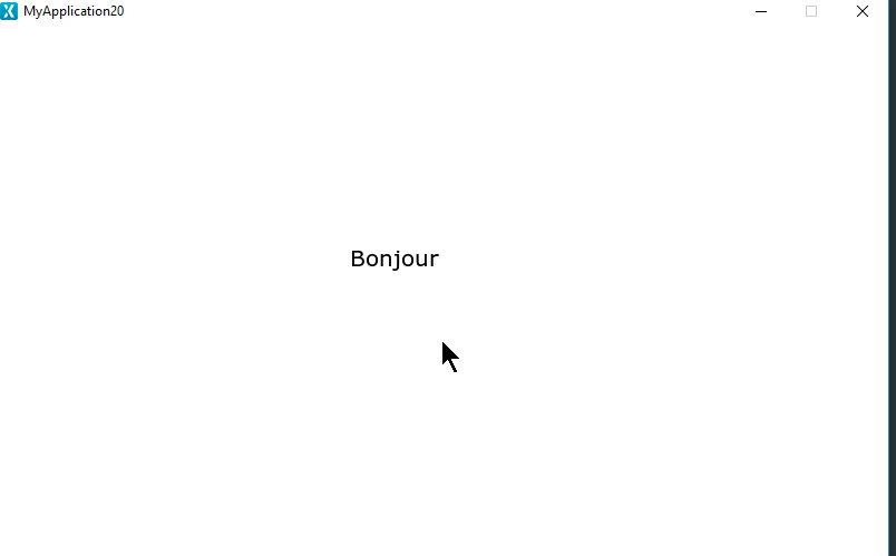

I have a display issue when I using the wildcard buffer.
I already used wildcard buffer by the past on a previous version of touch GFX.
I created a new project for a custom board and the problem is that I can't modify a text with the wildcard buffer.
See my function below :
void Screen1View::Button1clicked()
	Unicode::snprintf(textArea1Buffer, TEXTAREA1_SIZE, "Bonjour");
	textArea1.resizeToCurrentText();
	textArea1.invalidate();
On the screen the letters (B,o,n,j,o,u and r) seems to be all on the top of the others, all at the same position.

Not sure what's wrong with your application, but i re-made your example in 4.10.0:
  1. Created a TextArea with 1 wildcard.
  2. Set a buffer of size 20
  3. Defined a wildcard range of a-z,A-Z for the default typography used by the textarea
  4. Reused your code for setting the contents of the buffer

ALuca
Hello Martin,
Thank you for your answer ! I forgot to define wildcard range on this project...
After that all is OK..
Alexis
That's great, @ALuca​.
Does it make sense now? Since you don't know at asset-generation time which glyphs you'll need (no static strings defined) you'll choose a range of potential glyphs. E.g. if you're showing a text-message (which can be completely random) from a phone you need at least the entire alphabet + other symbols.
