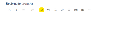

I invite you to edit your post and use this code sample button :
