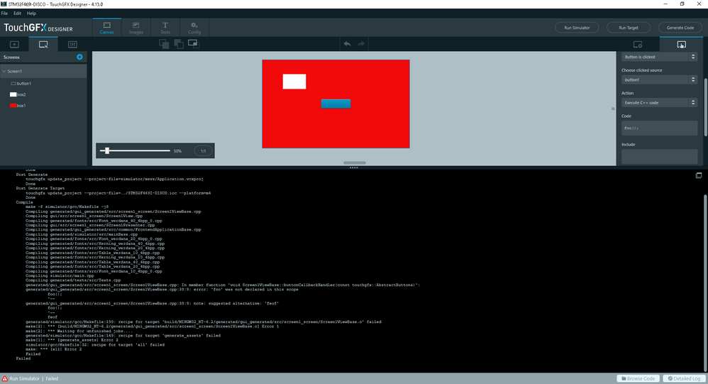

Build Log:
    Compile
        make -f target/gcc/Makefile -j10
        Converting images
        Compiling gui/src/startup_screen_screen/startup_screenView.cpp
        Compiling generated/gui_generated/src/startup_screen_screen/startup_screenViewBase.cpp
        generated/gui_generated/src/startup_screen_screen/startup_screenViewBase.cpp: In member function 'void startup_screenViewBase::buttonCallbackHandler(const touchgfx::AbstractButton&)':
        generated/gui_generated/src/startup_screen_screen/startup_screenViewBase.cpp:43:9: error: 'user_button_clicked' was not declared in this scope
                 user_button_clicked();
        target/gcc/Makefile:337: recipe for target 'build/ST/STM32469IDISCO/generated/gui_generated/src/startup_screen_screen/startup_screenViewBase.o' failed
        make[2]: *** [build/ST/STM32469IDISCO/generated/gui_generated/src/startup_screen_screen/startup_screenViewBase.o] Error 1
        make[2]: *** Waiting for unfinished jobs....
        make[1]: *** [generate_assets] Error 2
        target/gcc/Makefile:304: recipe for target 'generate_assets' failed
        target/gcc/Makefile:46: recipe for target 'all' failed
        make: *** [all] Error 2
        Failed
    Failed

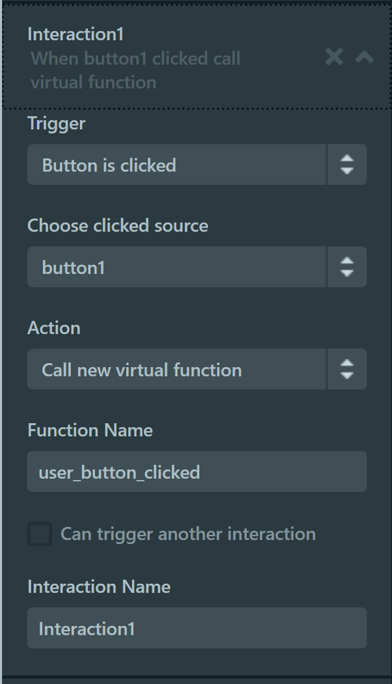

I see what you are doing wrong. The action when the button is clicked you set is "execute C++ code" and in the Code field you just call foo();, this function call will be generated in the generated file but this file has no knowledge about the definition of this function. Therefore you have this error.
The right approach is to set the action to "call new virtual function" then generate code.
Then you will see in the header of the generated file (for me it is Screen1ViewBase.hpp) :
     * Virtual Action Handlers
    virtual void user_button_clicked()
        // Override and implement this function in Screen1
Now you implement it in your files (mine are Screen1View.hpp and .cpp)
