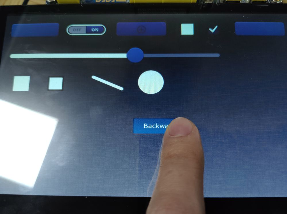

This is not a question asking post, just something I want to share. Hope will help people who meet the same problems I solved.
Last I asked lots of question about how to build a TouchGFX project.
You can find the original ask in [Does CubeMX 5.0.0 Ready to Build a TouchGFX Project?]
After few weeks work, I finally make this right. Now I'd like to share some information with you.
About my situation:
Host project builder: STM32CubeMX 5.0.0
Firmware package: STM32Cube FW_F4 V1.23.0
GUI builder: TouchGFX Designer 4.10.0 within the firmware package
ToolChain/IDE: TrueSTUDIO for STM32 9.0.0 convert from SW4STM32
Hardware: Custom PCB with STM32F429IG
LCD Panel: 1024 * 600, RGB565 interface parallel
Touch Screen: Capacity Multi-touch, IIC interface

Q6. Fall into an infinite loop in startup file after tastEntry() function called?
A6. Make sure you enable interrupts related to LTDC and DMA2D in CubeMX NVIC configuration.
Q7. LCD display some glitch-style content and program run into the Hardfault_Handler() function?
A7. Check in MX_FREERTOS_Init() function which is declared in freertos.c, and double the defaultTask stack size (in bytes) parameter. 128 to 256, 256 to 512 ,512 to 1024. The 1024 bytes stack size work for my situation.

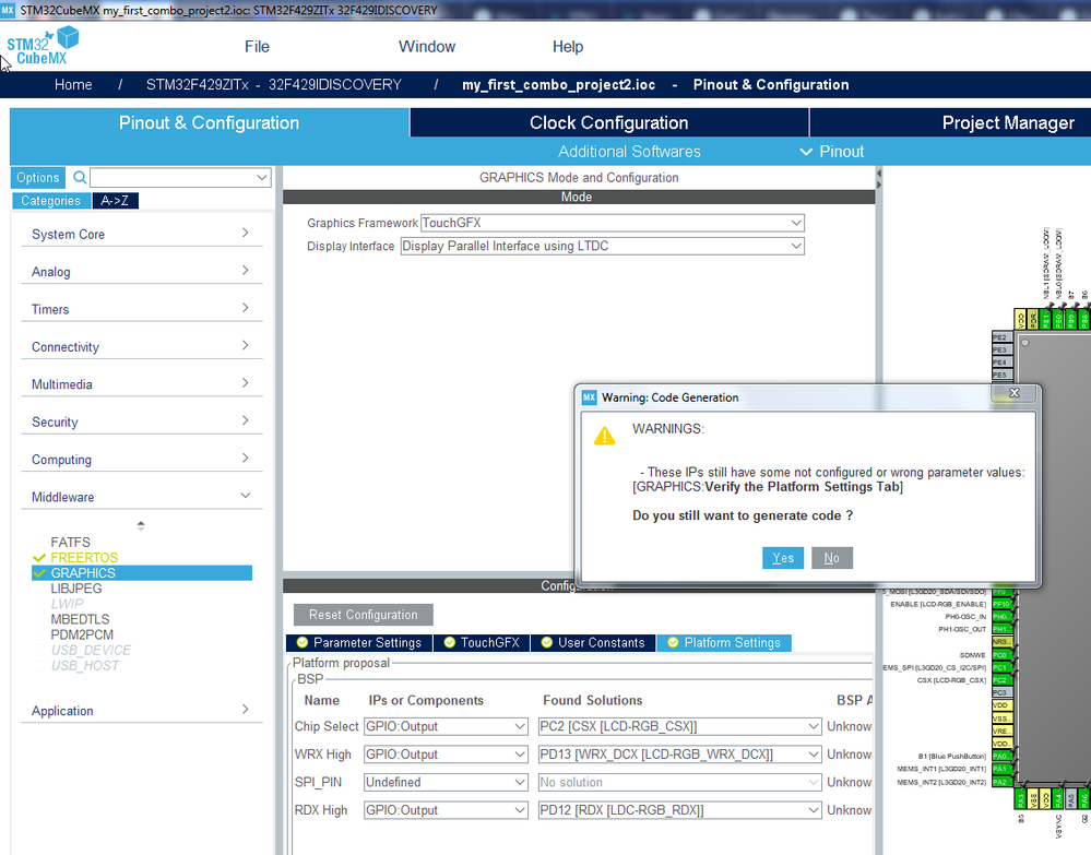

2018-12-17 1:02 PM
Hi. Here is the first draft document of the full procedure to support the STM32F429i-DISC1 target that we followed:
https://s3.amazonaws.com/axxonshare/my_combo_tutorial.zip
Welcome your feedback on the document and if it works for you. Good luck! :grinning_face:

Hi @Clark Sann , any chance you can consider the IAR compiler? The details on how to add the required files has been documented by Draupner at the supplied URL. Also just posted our process in the last hour on how to build a working project for the STM32F429 target (with touch panel).
2018-12-17 10:55 PM
Hi, @Mon2
Thank you for sharing this document, it resumes all step to build a project with TouchGFX and CubeMX... I have 2 questions :
- what is the role of SPI that you enabled in page $5 ?
- what is also the role of USB_OTG_HS ?
Regards
2018-12-18 4:56 AM
Hi @elguezzar . Enabled the SPI pin to only relax the raised error / warning from the STM32CubeMX tool. Not sure if it is really required for operation as it appears that the ILI9341v controller onboard the TFT display is being configured using I2C. Can disable and still proceed to generate the code for testing upon reaching the office in a few hours. Based on the schematics for the STM32F429i-DISC1 kit, the PF9 = MOSI is used but may be our misunderstanding. Will experiment and write back with the updates.
The use of the USB is at your option. Do not believe there was any impact to leave this port function enabled. Once this package is operational, you are free to enable / disable ports of your choice using the powerful CubeMX tool to generate most of your code. To be honest, without such tools, not worthwhile to even consider the ST line as there is far too much low level code that is required to be operational.
