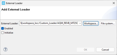

Holy Carp!
My external loader was more or less working all along. I just needed to not have "initialize" checked in the external loader debug settings.
An ST field applications engineer took a look at it and that was all it was. I'll try to post a follow up with a few more details on Monday, but that was pretty much it. Many thanks for those of you who offered advice, and a special thanks to @Tesla DeLorean for trying to help me work through it.

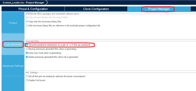

Next, I changed the Project Manager / Code Generator settings to "Generate peripheral initialization as a pair of '.c/.h' files per peripheral". This makes the peripheral file setup match how the previously mentioned template code in the stm32-external-loader contrib repository.

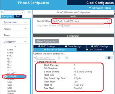

Next came the QUADSPI setup for the MT25QL128. The QuadSPI mode was set to 'Bank2 with Quad SPI Lines', and set the rest of the Parameter Settings as below:
Notes:

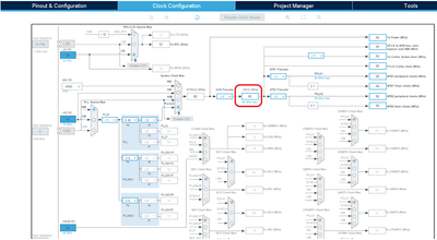

1. The Clock Pre-scaler - I'm still a little fuzzy on how to set this based on the datasheet values of the memory, but my clock was pretty close to the one in the tutorial, so I went with it and it worked.
2. Fifo Threshold - again, I went with the value recommended in the tutorial of '4'
3. The flash size is given in a table in the tutorial (excerpted here)
4. All the rest of the settings were left in their default.

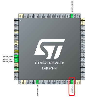

Finally, I needed to change the QUADSPI_CLK line from its default pin to PB10 due to constraints in my design (the default pin for this signal was in use for other purposes in my design).
With that adjustment made I saved and generated code. Now it was time to bring in the code template files from the stm32-external-loader repository.

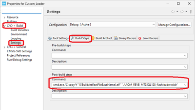

Final External Loader Project Settings (Generating the STLDR file)

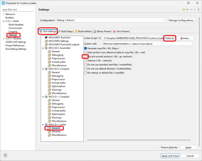

Now I needed to change linker files to the linker.ld and generate the .stldr file. This was also covered pretty well in the tutorial, but all that has to be done is modify the projects options to:
1. In C/C++ Build --> Settings --> Tool Settings --> MCU G++ Linker/General: I Pointed to the linker.ld file and uncheck "Discard unused sections"
2. Under C/C++ Build --> Settings --> Build Steps, I added the following command to the "Post-build steps" Command: \'cmd.exe /C copy/Y "${BuildArtifactFileBaseName}.elf" "..\custom_flashloader_name.stldr"
I then pressed the Apply and Close buttons and rebuilt the project. The AQM_REVB_MT25QL128.stldr appeared in the project's root folder. I copied this file to the location of the other external loaders for the STM32CubeProgrammer so that I could test the generated loader. The location on my computer for the external loaders was here:

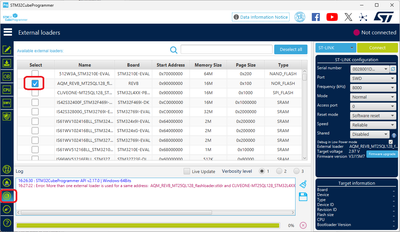

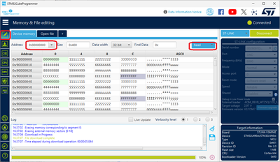

Testing the external Loader with STM32CubeProgrammer
Opening STM32CubeProgrammer, I clicked the External loader button, scrolled through the list, made sure all other external loaders were not selected, and then selected my custom loader.

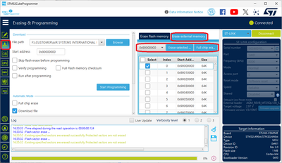

Then I went to the Erasing and Programming tab, and attempted an erase on the external memory on one of the segments, and then the entire memory. Both seemed to complete successfully.

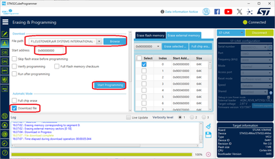

Next, I browsed for the testbinary1M.bin (\stm32-external-loader-contrib\QSPI_testing\), checked the "download file" box, changed the Start address to 0x90000000 (the memory mapped address for a quadspi flash), pressed "Connect" and "Start Programming".
With that working, the final test was to read the memory and see if it contained the expected values. On the Memory & File Editing tab, I changed the address to 0x90000000 and clicked "read", and confirmed everything was as expected (the TestBinary.hex file contains a sequence 32 bit numbers 00000000, 11111111, 22222222, etc).
With that out of the way, I was pretty confident my external loader was functioning properly. Now it was time to start integrating the loader with my main application.

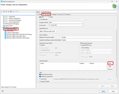

Setting up the External Loader in the Main Application
Finally, the last step was to enable the external loader in the main application's debug settings. I did this by pushing the arrow next to the debug button and selecting "Debug Configurations...". With my project selected in the left-hand pane, I clicked on the debugger tab, scrolled down to "External Loaders" and clicked the "Add..." button.
In the "Add External Loader" I clicked the "workspace..." button and directly pointed it to my custom loader - no need to copy it to a special external loaders directory! I suppose that might be helpful to do later on if I were using it on multiple projects, but for now this works well and makes it so if I make any changes to my external loader, they'll be automatically incorporated in the next debug session for my main application. Also be sure to check the "Enabled" check box, and DO NOT CHECK the "Initialize" (the root of my problem).
Why don't click the initialize button you ask? According to the STM32CubeIDE user manual (um2609-stm32cubeide-user-guide-stmicroelectronics.pdf:(
"When the [Initialize] property of an external loader is enabled, the loaders Init() function is automatically called after reset operations. It can be used to configure the device for external memory access. Usually, the debugged application must perform the initialization."
I guess its saying that it calls the loaders Init() function again after it finishes using the external loader, which would then mess with my main apps initialization?
