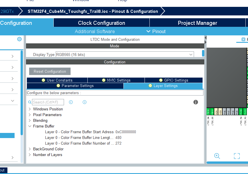

your framebuffer start address should be 0xC0000000

I tried 0xC0000000. But the screen is blank. Is this address we can choose by our own?

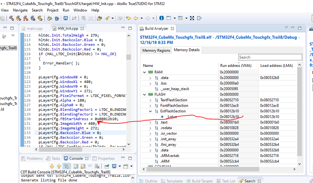

I guess hardware is working good because when i Place the pLayerCfg.FBStartAdress = 0x08012b10 in the HW_Init.cpp file ,then i can see the image on my tft screen .see the snapshotbelow.
But i am expecting that when the osKernelStart(); is executed in the main.cpp , the tft screen should be showing the images from the touchgfx .But it is not.
I used different values of start frame buffer address in cubemx.but nothing helps.0690X00000BugWAQAZ.png
