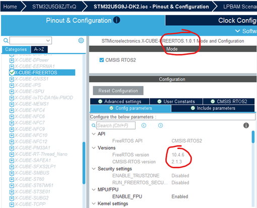

X-CUBE-FREERTOS-1.0.1   (FreeRTOS version 10.4.6)

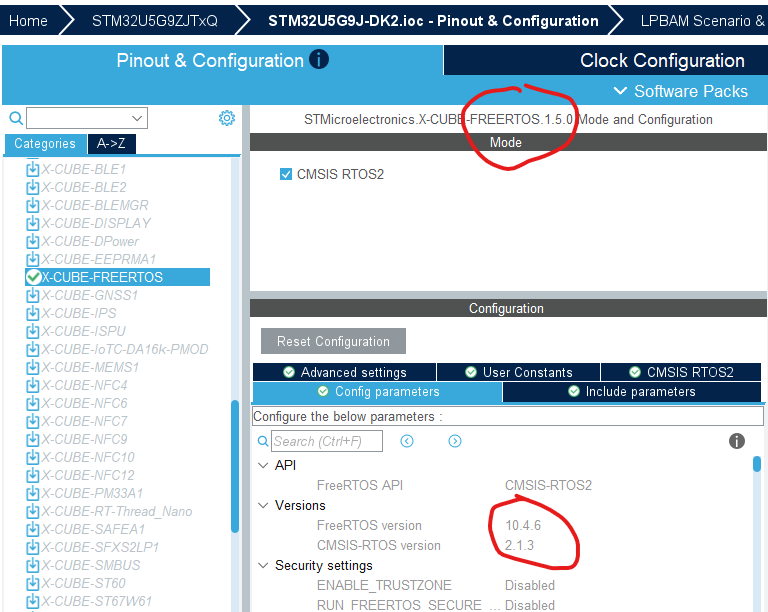

I migrate to newer version
X-CUBE-FREERTOS-1.5.0   (FreeRTOS version 11.2.0)
But version did not change from 10.4.6 to 11.2.0

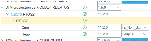

If I open the attached .ioc file in a text editor, I can see that the version is actually updated. The issue is only related to the STM32CubeMX UI and not the generated code.

I managed to get it to display the correct version in the UI by disabling and then re‑enabling the component.

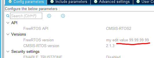

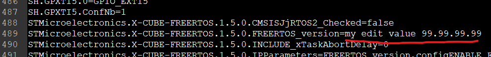

This does not work on my machine. I found out that the displayed version is number/string assigned to
TMicroelectronics.X-CUBE-FREERTOS.1.5.0.FREERTOS_version
variable.
I change that string manually and it is displayed as the version.
