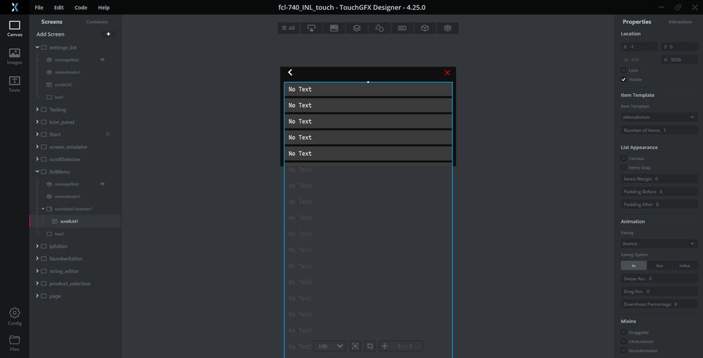

We have an issue with a scroll list widget, on the hardware when you touch and scroll to a point, stop then lift your finger of the display the list accelerates  in the direction it was dragged in initially. This behaviour is not seen the simulator.
In the designer, we have scrollable container with a scroll list inside it. Setting animation has no effect, easing option = In, Swipe Acc = 0, Drag Acc = 0, Overshoot % = 0. we have tried adjusting the both Acc without any effect.
The list has up to 50 entries.scroll listscroll list

Hello @Eddie1066.
Since it works in the simulator, I suspect an issue with your touch controller, most likely in the software layer that transfers touch inputs to TouchGFX.
Could you try to perform a thorough test of the touch data you are receiving (coordinates, events, and timing) and verify that it matches your inputs?
