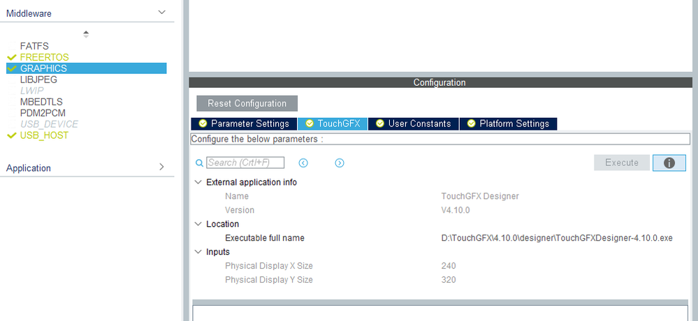

Hi all,
I'm starting with touch GFX on STM32F429 discovery, I find the firmware example, but I want to have the cubeMx template project for the STM32F429 discovery example ?
Can ST share it ?
the second issue that I'm facing is that sometimes when working with touch GFX designer I have the following error : "Error during code generation" and when occurred I can't anymore Run Target and simulator, so I'm obliged to create another new project.
Can anyone tell me how to solve this issue please ?
Thx

Hi @Community member​,
Have a look at this .ioc file. It creates an IAR projects that compiles. You can read this article that details how to finish the configuration of the project.
https://touchgfx.zendesk.com/hc/en-us/articles/360021620431-Configuring-STM32F429I-DISCO
The STM32F429I-DISCO application template will be out soon so you can access the .ioc file through projects you create using the TouchGFX designer.
Hope it helps!

Hello Martin,
Thanks for your response.
I have an issue with the cube project you sent, I configured the right path of GFX Designer, but the "Execute" bottom is not activated?!!
Attached an image.
Could you please help ?
thx
Mon2
Senior III
Try to go to a different tab and then come back to this screen. Does that fix the Execute button?
You can also review this thread:
https://community.st.com/s/question/0D50X0000A7Y1xxSQC/stm32f429idisc1-tutorials-with-iar-and-sw4stm32-compilers-with-touchgfx-stm32cubemx
Please post your results for future readers.
No that does not fix the issue.
I tried with the package that I found in this thread
and the "execute" Bottom is working.
I'm trying now to make a clean project with MDK KEIL.
If you have something please share.
Thx
@Community member​ , from the last time we reviewed the use of MDK Keil, the compiler did NOT work. Believe that Keil and Atollic integration are being worked on by the ST staff. If you do find a solution or if it works for you, please post your update here for future readers. Thanks.
As of now, an .ioc file in the F429 is not included in the TouchGFX DEsigner example, but please note that we are working on implementing a F429 TouchGFX  Designer example which includes an .ioc file.
Are you able to share your TouchGFX Log file? Thank you.
