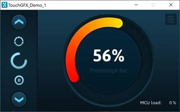

I was wondering if anyone have made a 'rotary-style' button, like a rotary encoder or a volume knob that can go on-screen?
I suspect it would involve resolving a touch input and mapping it to some sort of circular motion or something like that. A rounded slider would also be of high interest!
Any inputs would be appreciated! Thanks!
Romain DIELEMAN
In Demo 1 you have an example of a circle progress bar that you manually increase and decrease, I suppose this is what you are looking for. Look at the CircleProgress.cpp and hpp files to have an understanding of how it was implemented.

Beautiful! Thanks, I knew I had seen something like that somewhere :D I'll dive into that code now!

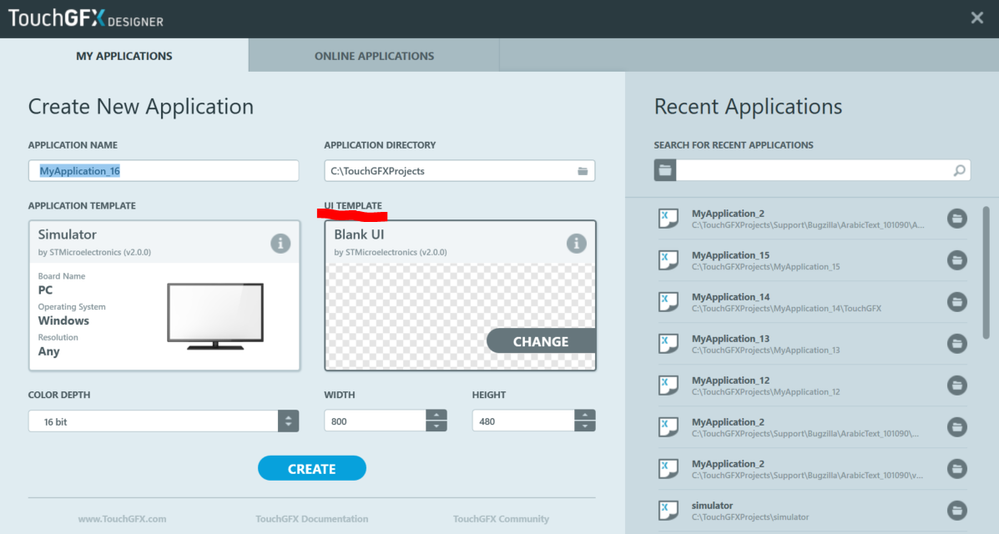

MYass.2
I am interested in this demo, where I can find it?
Thank you in advance for your reply.
This demo is available when you create a project in TouchGFX Designer under the "UI template" section.

MYass.2
It's the perfect example I'm looking for, thank you Romain.
perfect then ;)
