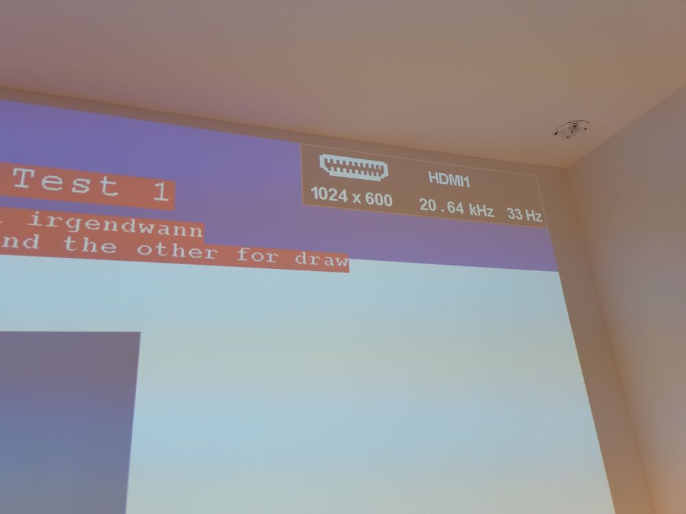

I found a few issues, but the Image still gets drawn several times.
I used a Video-timing-calculater to set all the values like Front/Back-porch and so on, but I can´t find a way to get rid of the described problem.
I am running the example Programm with two image-Buffers.
To specify the used Display:
Waveshare 7" with 1026x600 (somehow sold as 800x480)
Margins disabled,
Interlace disabled
DVI-Mode
When I connect the board to my projector, I can get a bit information about the Signal maybe that helps identify the Problem0693W000008G4crQAC.jpg0693W000008G4cmQAC.jpg

I have one problem sorted out, the Image-Buffer did not have the right size. Now, the image gets shown correctly. However, it looks like everything has a light shaddow a few mm underneath the real image. Does anybody have an idea on hoe to change that?
@ Tesla Delorean, How can I change the Hz of the image? In the example you kindly provided, it is set to 60hz, but in my programm I can only get it up to 33Hz.
Thank you for your help so far!

You have to clock fit the Pixel and DSI correctly to match the expectations, and not exceed defined limits
HDMI_FormatTypeDef HDMI_Format[] =
/* HA HS HB HF VA VS VB VF ASPECT BPP */
//#20
 {1024, 48,216, 24, 600, 5, 22, 3, HDMI_ASPECT_RATIO_16_9, LCD_DSI_PIXEL_DATA_FMT_RBG565}, // 1024x600 16-bit
//#21
 {1024, 48,216, 24, 600, 5, 22, 3, HDMI_ASPECT_RATIO_16_9, LCD_DSI_PIXEL_DATA_FMT_RBG888}, // 1024x600 24-bit
HDMI_DSIPacketTypeDef HDMI_DSIPacket[] =
 /* NP NC VP */
 {0, 1, 1024}, // #20
 {0, 1, 1024}, // #21
HDMI_PLLConfigTypeDef HDMI_PLLConfig[] = // Clock Fit by sourcer32@gmail.com
/* N DIV Pclk IDF NDIV ODF LBClk TXEscapeCkdiv*/
//#20
	{395, 4, 49375, DSI_PLL_IN_DIV5, 79, DSI_PLL_OUT_DIV1, 49375, 3}, // 1024x600@60Hz 16-bit 49.375 MHz / 395 MHz
	// V:59.7Hz, H:36.7KHz
//#21
	{330, 4, 41250, DSI_PLL_IN_DIV5, 99, DSI_PLL_OUT_DIV1, 61875, 3}, // 1024x600@50Hz 24-bit 41.250 MHz / 495 MHz
 // V:49.9Hz, H:31.4KHz

Thank you! Now it works with the desired frequency.
Can you tell me how I can calculate those numbers?
Earlier I used a timings calculator (https://tomverbeure.github.io/video_timings_calculator) to get the Numbers in "HDMI_Format[]"
But I don´t know how I can come up with the Numbers in "HDMI_PLLConfig[]"

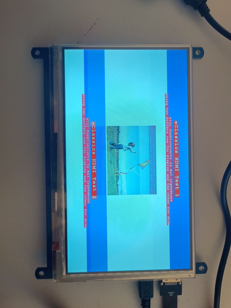

And there is one more issue. Connected to my projector or computer-Monitor, everything seems to be fine. But at the waveshare display, there is a shaddow a few mm under the real image. It is also there in your 1024x600 example. There is also a burn-in towards the edge that disappears after a few minutes when it´s unplugged (this does not appear when I connect the Display to my computer) I have ordered a new display to be shure it is not a problem of the Unit.
However I noticed that this shaddow comes further down, when I change the Numbers in "HDMI_Format[]" to
{1024, 104, 176, 72, 600, 10, 33, 3, HDMI_ASPECT_RATIO_16_9, LCD_DSI_PIXEL_DATA_FMT_RBG888}
Those Numbers were calculated by the Timings calculator for 120Hz. I tested it just out of curiosity. Every other Setting stayed the same.0693W000008GB0aQAG.jpgThank You!

The line timings are based on ones I found in a 1024x600 panel manual, seemed to be some flexibility in those. I didn't find a good reference, so I used ones that worked on my multisync UHD monitor. You could use your own numbers, or dig up the manual for the panel WaveShare is using.
The PLL timings I did with a pencil and paper based on my understanding of how raster displays work, and the limitations of the DSI and STM32 design to hit certain numbers. Tends to flow through the pixel clock, and the rated capacity of the DSI in 2-lane configuration. I can mechanically generate timing tables. The DSI clock needs to meet or exceed the pixel data rate, and not exceed 500 MHz. The 2-lanes is limiting. I think 1366x768 is about the limit of the STM32 implementation.
Monitors tend to want things hitting close to 50 or 60 Hz frame rates, whereas LCD panels of fixed geometry, are concerned primarily with pixel clock frequency range.
Dark corners are more of a back-light issue.
