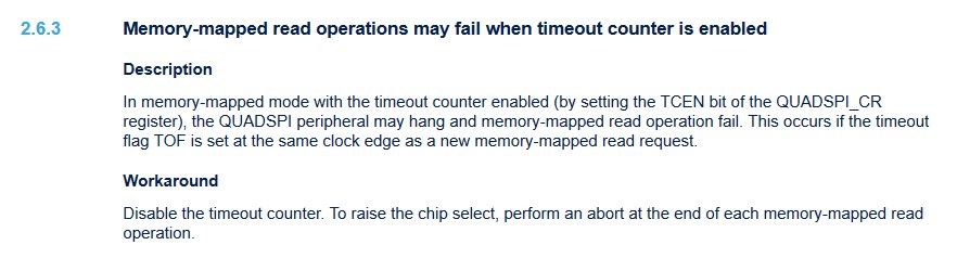

I have a project where I want to place the TGFX resources (images, translations, fonts) in a memory mapped QSPI flash. In this instance I have placed them in this flash via the linker (.o files) rather than using binary fonts etc.
The crash occurs generally when switching screens. I can usually switch screens successfully a number of times. Sometimes it fails after 30 screen switches, sometimes 5. I've also seen it fail when updating smaller elements. The crash also prevents the debugger (IAR / I-Jet) from stopping, so I've had no luck there. Debug log: "CPU did not stop"
I find the problem goes away if I put the TGFX fonts back in internal flash. It also goes away if I switch back to full frame buffers rather than using partial frame buffers. ( I have restrictions on ram usage, so partial frame buffers are needed)

Update: I disabled the QSPI timeout counter as mentioned in the device errata and the problem appears to have gone away.
