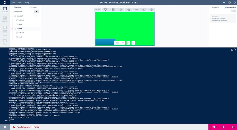

I have a problem with TouchGFX.
I updated Windows to Windows 11 recently.
I can't compile it after it is updated.
This is my error message.
Run Simulator
  Generate
    Done
  Generate Assets
    make -f simulator/gcc/Makefile assets -j8
    Reading ./application.config
    Done
  Post Generate
    touchgfx update_project --project-file=simulator/msvs/Application.vcxproj
    Done
  Compile
    make -f simulator/gcc/Makefile -j8
    Compiling gui/src/screen2_screen/Screen2View.cpp
    Compiling gui/src/screen2_screen/Screen2Presenter.cpp
    Compiling gui/src/screen1_screen/Screen1Presenter.cpp
       0 [main] us 0 init_cheap: VirtualAlloc pointer is null, Win32 error 487
    AllocationBase 0x0, BaseAddress 0x60EA0000, RegionSize 0x160000, State 0x10000
    C:\TouchGFX\4.18.0\env\MinGW\msys\1.0\bin\mkdir.exe: *** Couldn't reserve space for cygwin's heap, Win32 error 0
    make[2]: *** [build/MINGW32_NT-6.2/gui/src/screen2_screen/Screen2View.o] Error 1
    generated/simulator/gcc/Makefile:196: recipe for target 'build/MINGW32_NT-6.2/gui/src/screen2_screen/Screen2View.o' failed
    make[2]: *** Waiting for unfinished jobs....
    Compiling gui/src/screen1_screen/Screen1View.cpp
    generated/simulator/gcc/Makefile:196: recipe for target 'build/MINGW32_NT-6.2/gui/src/screen2_screen/Screen2Presenter.o' failed
    make[2]: *** [build/MINGW32_NT-6.2/gui/src/screen2_screen/Screen2Presenter.o] Error 1
    make[2]: *** [build/MINGW32_NT-6.2/gui/src/screen1_screen/Screen1Presenter.o] Error 1
    generated/simulator/gcc/Makefile:196: recipe for target 'build/MINGW32_NT-6.2/gui/src/screen1_screen/Screen1Presenter.o' failed
    Compiling gui/src/model/Model.cpp
    generated/simulator/gcc/Makefile:196: recipe for target 'build/MINGW32_NT-6.2/gui/src/screen1_screen/Screen1View.o' failed
    make[2]: *** [build/MINGW32_NT-6.2/gui/src/screen1_screen/Screen1View.o] Error 1
    make[2]: *** [build/MINGW32_NT-6.2/gui/src/model/Model.o] Error 1
    generated/simulator/gcc/Makefile:196: recipe for target 'build/MINGW32_NT-6.2/gui/src/model/Model.o' failed
    generated/simulator/gcc/Makefile:155: recipe for target 'generate_assets' failed
    make[1]: *** [generate_assets] Error 2
    simulator/gcc/Makefile:32: recipe for target 'all' failed
    make: *** [all] Error 2
    Failed
  Failed

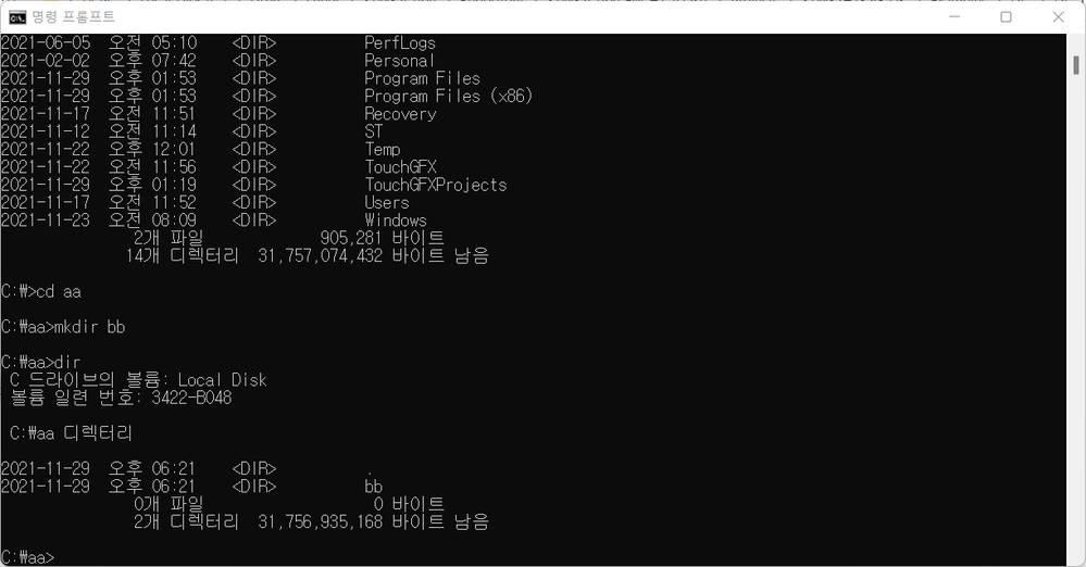

Yes, I tried to mkdir in the Command window.
It works fine.
