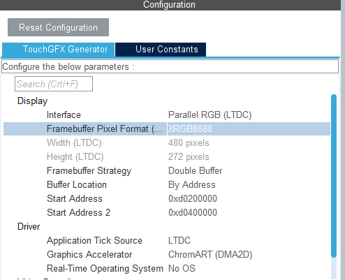

Thanks for the suggestion. Is there anything else I need to do to setup the XRGB painter? I didn't find anything in the documentation. I changed the Framebuffer Pixel Format in the TouchGFX Generator to XRGB8888. This has fixed the issue from above but there is a new problem, see below.

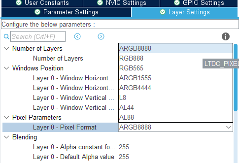

There is no XRGB option in the LTDC settings, does this matter?

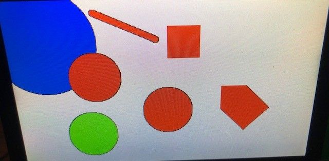

Now the Canvas widgets and some text (not shown) has a black outline to it. Problem with pixels with alpha?
psilvaggio
I found a workaround for the black outline on Canvas widgets issue which resulted from switching to the XRGB8888 format. If I have a Box widget the size of the entire screen on top of everything else with alpha > 0 (I made it 1 so it didn't affect the look of the rest of the screen), the black outline problem went away and everything looks good. It would still be nice to see a little more explanation/documentation on why ARGB8888 doesn't support non-byte-write, but this is no longer a show-stopper issue.
