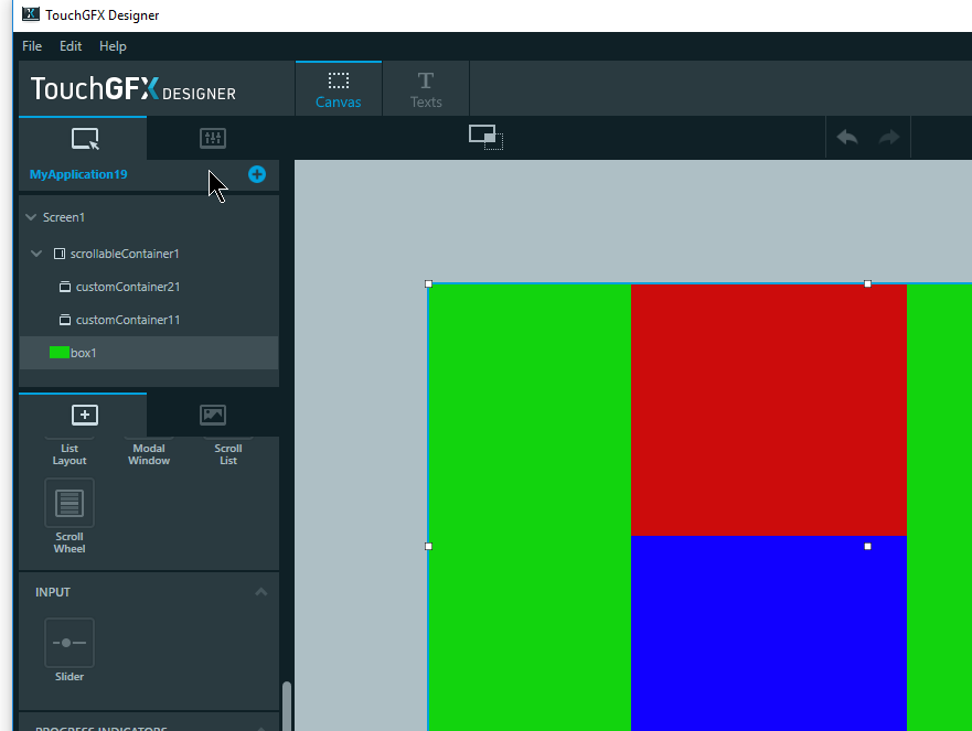

Now I'm having another problem, that the container ist not the foremost. The container is displaying behind textAreas.
How can I set the container to the front?
Regards
Dejan
Martin KJELDSEN
Chief III
Hi @Dejan Nedeljkovic​,
No problem. You can configure the z-order of widgets in the designer by simply dragging them up and down. In this application, the green box is the background (Furthest down in the widget tree).
Thank you, that helped.
