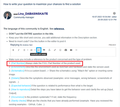

You still need to provide the part number: How to write your question to maximize your chances to find a solution
I am using the STM32F407VG part specifically
