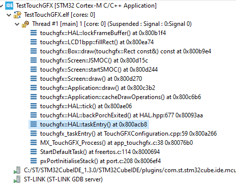

I'm not able to run a very basic (a black screen) TouchGFX application on my hardware. I have follow the TouchGFX documentation and the STM32L496G-DISCO application example, but i wasn't lucky..
In particular I never reach the breakpoint that i put in the TouchGFXHAL::flushFrameBuffer(const touchgfx::Rect& rect) method. Also, if I suspend the debug, i see that the application stack arrive at the method touchgfx::HAL::lockFrameBuffer().
I have modified only the TouchGFXHAL class, in attatched there are this class files, following the documentation and the example metioned above, but maybe i miss something.
Please someone can give me some help?

‎2020-06-22 3:24 AM
Yes i try to debugging! But is not simple to follow the code.
This is the call stack of the application when i pause it:
‎2020-06-22 7:15 AM
This is a 1bpp application? (LCD1).
Looks like its blocked trying to take a lock the farmebuffer.

Yes it seem blocked but i don't know why.. Can you tell me if I miss to implements something or maybe i have done some wrong setting?
