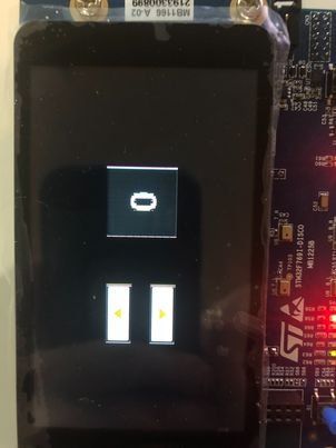

I use development board with F769 and 32-bit sdram
Artifacts a dissapear when I use 16 bit SDRAM mode. Artifacts are disappear then I use RBG565
But I want 32-bit SDRAM and RGB888

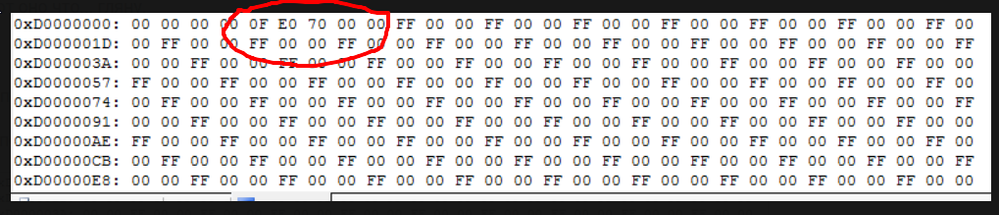

What can I see in memory, when I try to fill by color 0x0000FF
First bytes are broken

P.S. IMPORTANT! These errors I see when I use DMA2D.
If I write and read to SDRAM without DMA2D - all OK.
