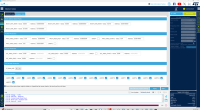

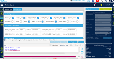

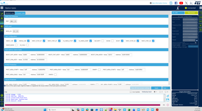

1. Verify the BOOT0/BOOT1 pins – make sure they are configured to boot from flash memory.
-> Yes the SW1 position is at FLASH, Pointing at 0.  BOOT0 Jumper is OPEN(no jumper connected, JP3).
2. Check the linker script – confirm that the application is being written to the correct flash start address.
-> Attached 2 files, this might provide clue, 1 is for the Flash.ld and other is for RAM.ld
3. Make sure Option Bytes are correct – especially the Read-Out protection and Write protection settings.
--> Attached below 2 images for the settings.
