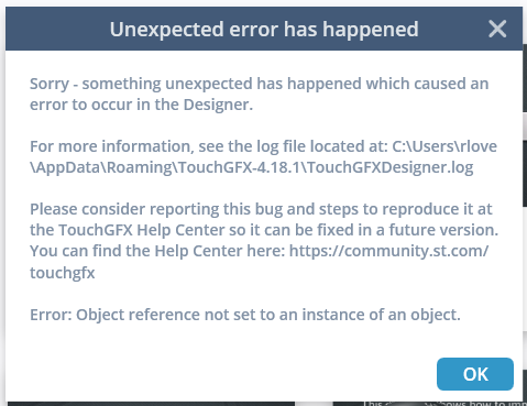

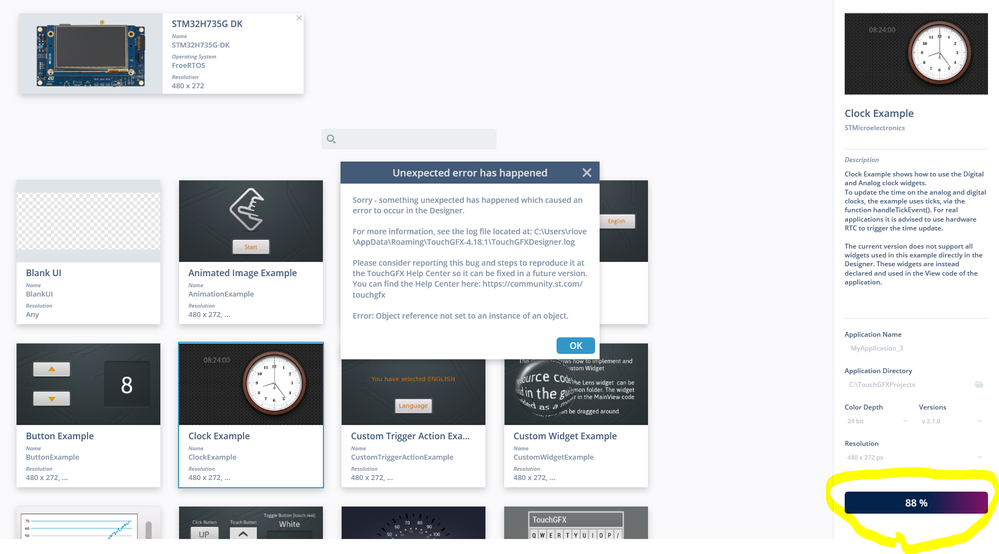

When I generated example of GFX designer, unexpected error has happend.
​TouchGFX Designer-4.18.1 stopped at 88%0693W00000JP58aQAD.png0693W00000JP59eQAD.pngI already tried to uninstall and reinstall but without success.
And the TouchGFXDesigner.log as follows.

2022-02-09 13:12:38,340 [14] ERROR TouchGFXDomainModel.LoadSave.LoadSave: TMP is not writable: C:/Users/rlove/AppData/Local/Temp
TEMP is not writable: C:/Users/rlove/AppData/Local/Temp
system temporary path is not writable: C:/Users/rlove/AppData/Local/Temp
System.Exception: TMP is not writable: C:/Users/rlove/AppData/Local/Temp

2022-02-09 13:12:38,351 [1] ERROR TouchGFXDesigner.App: Object reference not set to an instance of an object.
System.NullReferenceException: Object reference not set to an instance of an object.

Hi rloveusm,
Seems that you don't got the permission to write in your TMP folder (C:/Users/rlove/AppData/Local/Temp).
Can you please check your rights permissions on that folder ?
Otherwise, if it still doesn't work, please try to run TouchGFXDesigner as an administrator.
/Yoann
