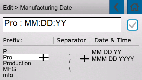

I am trying to add up texts from different scroll lists and show up in one textArea as a concatenated string as image shown below :-
0693W00000NroScQAJ.bmpI have tried converting the typed text to Unicode::UnicodeChar and then applying Unicode::strncpy but it completely replaces the text.

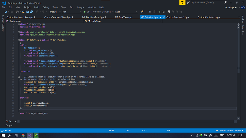

Hello A.Qasim,
Can you show how you declared your *st3 and also your textArea1 declaration ?
/Osman
Osman SOYKURT
0693W00000NrudMQAR.pnghere i have declared the st3

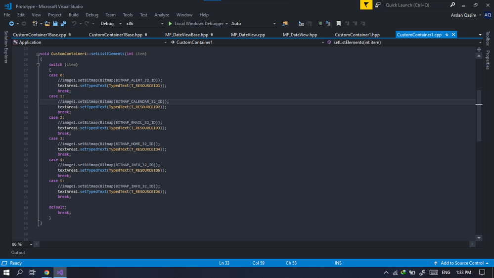

0693W00000Nruj0QAB.pnghere I have declared values in textArea under prefix heading
Hello A.Qasim,
Ok, first maybe reduce the length of your strings, 50 is too much from what I see of your UI. Secondly, all your st1, st2 and st3 length are 50, so if you do *st3 = *st1 + *st2 it can't fit. So if you want to keep 50 as the length of your st1 and st2, then try with st3[100].
And last remark, have a look at strcat() function ;)

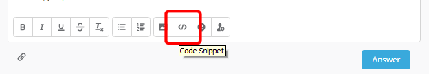

@A.Qasim​  - how to properly post source code:
0693W000008wfhEQAQ.png@A.Qasim​
