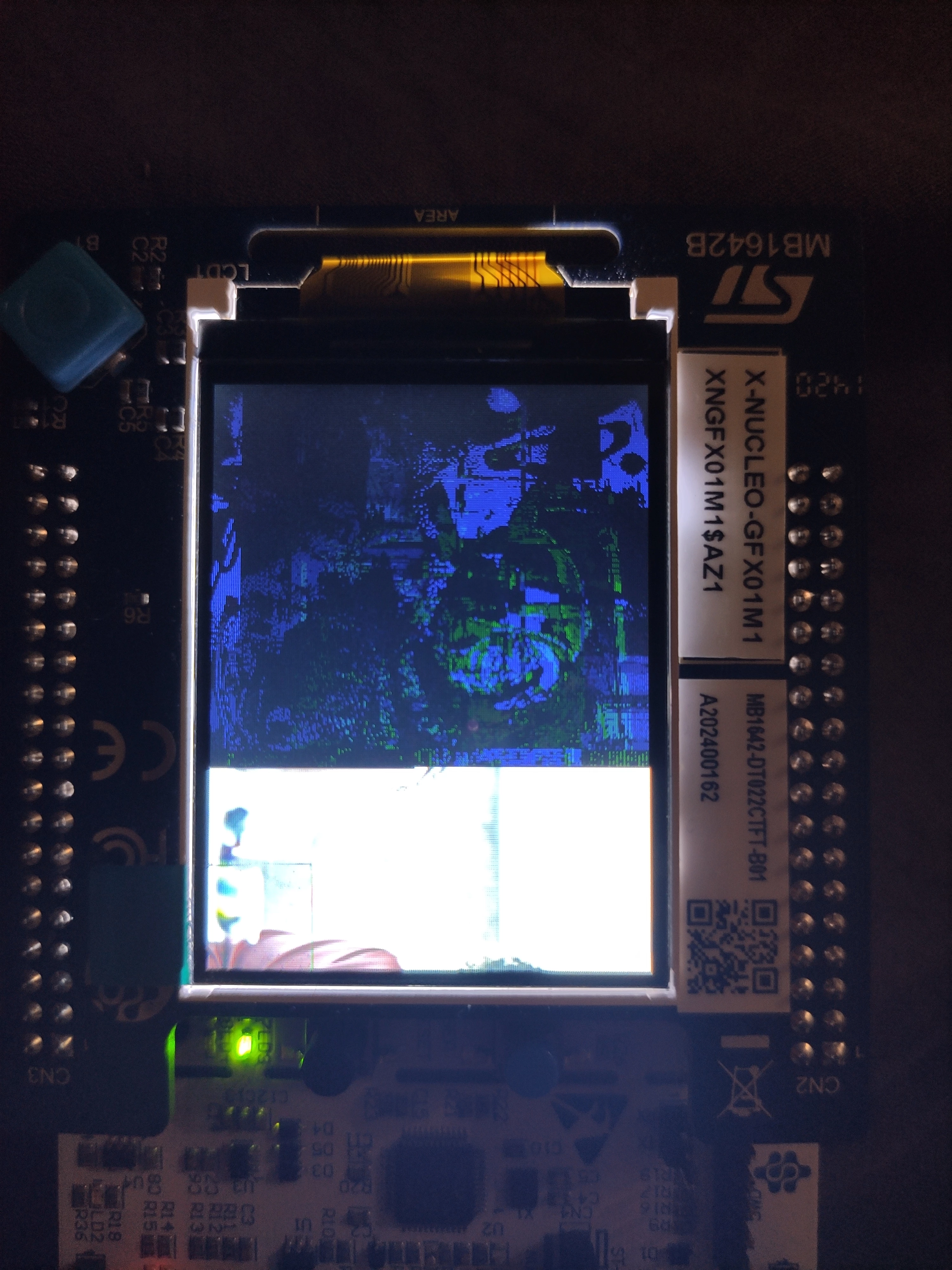

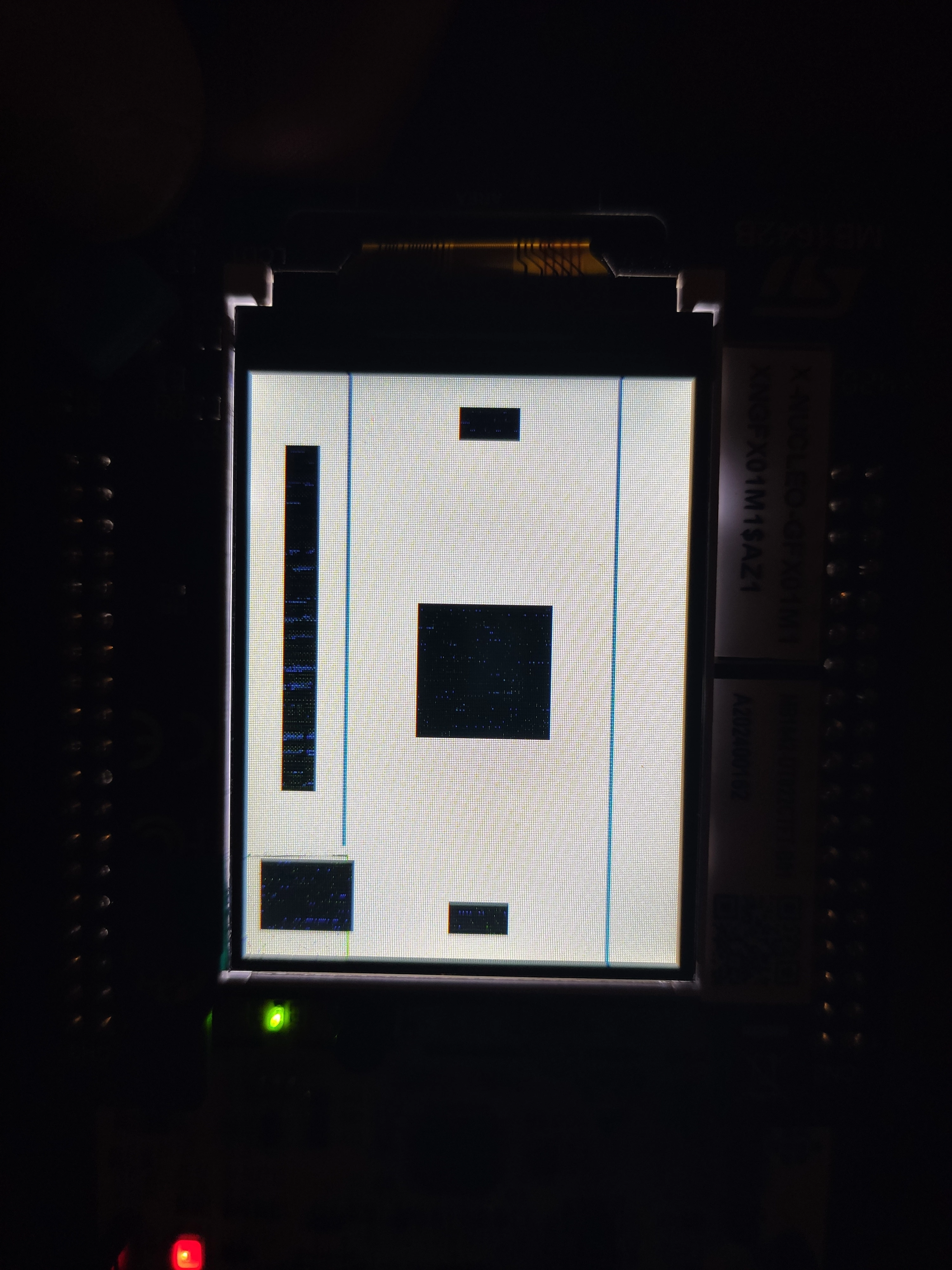

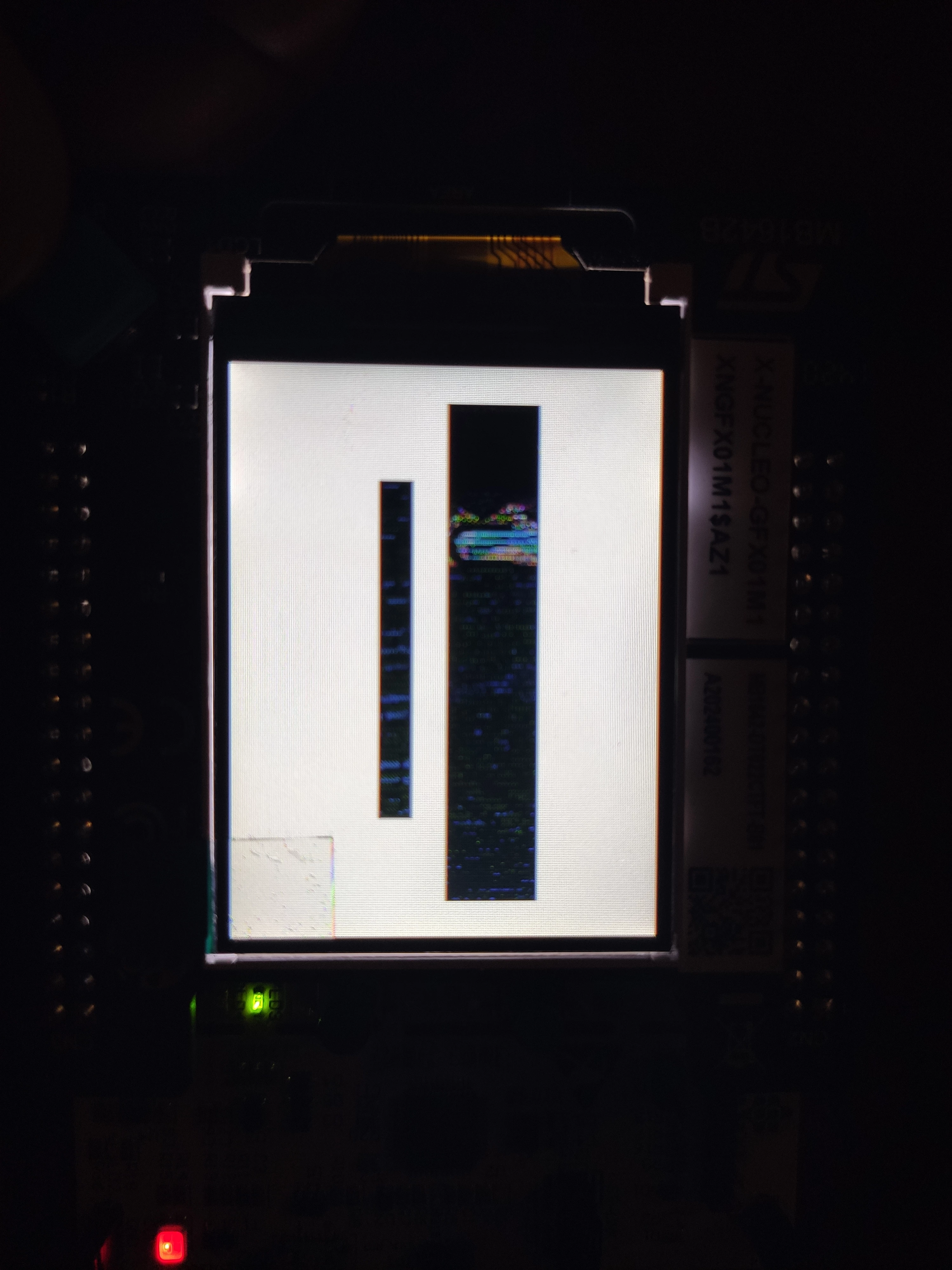

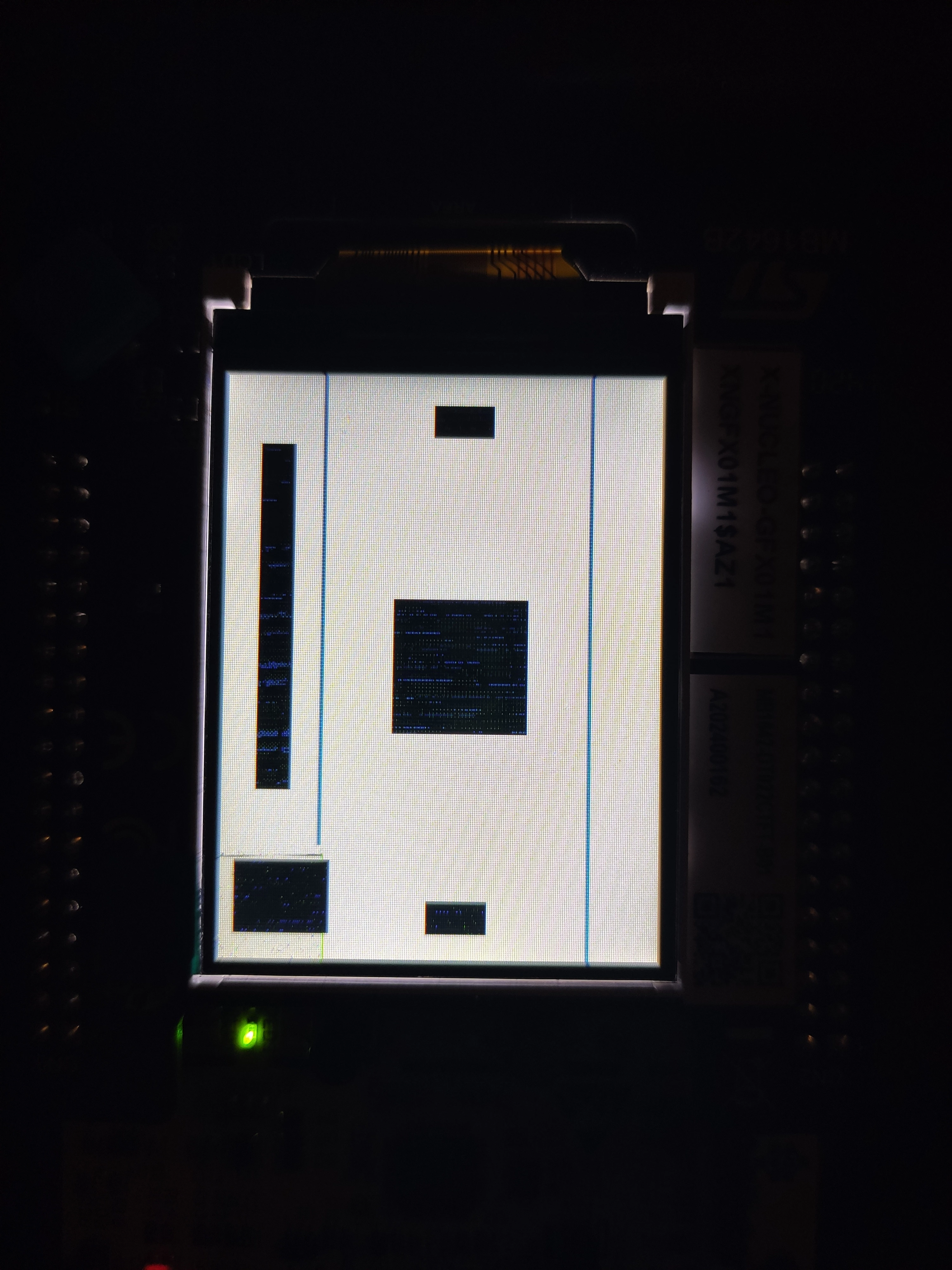

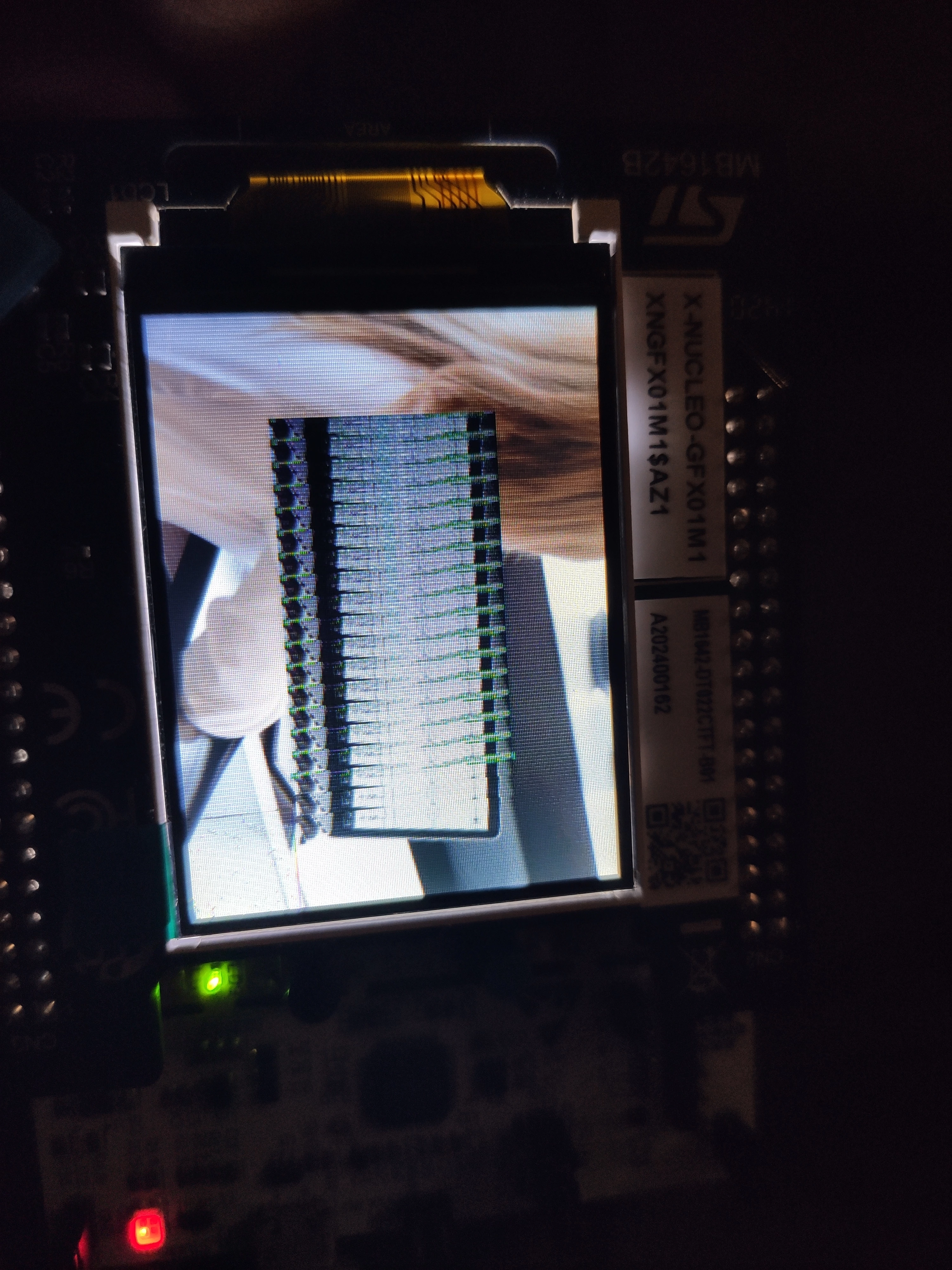

Hello ,
Im currently exploring Touch gfx capabilities on low cost hardware (STM32G071  + SPI LCD shield) , and i comme across a bug .
steps to reproduce :
  • Start a fresh new project on Touch GFX using online demo , choose STM32G071 demo
  • Load a few additional image to project (a series of 40 png issued from a splitted .gif file total size : 150kb
  • Connect board
  • generate code and flash target
Results : some images of GUI gets missed up ( black lines ) like : navigation arrow , touch gfx logo and some texts disappear .
I suppose this is due to low ram available , can you please explain ow touchgfx is allocating cache for bitmaps in demo project? since the board has a NOR non mapped flash chip for assets storage does it mean that all assets are being cached on startup ? if yes why touchgfx still call for SPI data reader each time i switch screen ?
Sorry for long post but i'm quit confused : / , many thanks in advance
Ps : please find attached te additional images i'm using
Ps2: The additional images are just loaded into project but never used or referenced , so i find it quit awkward that they are being loaded into cache since there is no call for them
Best answer by N. SANTINI
I just checked the source code of the external loader and you are fully right, it contained 64 sectors instead of 128 in the description.
This was not noticed since the demo had enough room for its assets.
Please find attached a corrected version of the external loader, just unzip it in the following folder :
c:\Program Files\STMicroelectronics\STM32Cube\STM32CubeProgrammer\bin\ExternalLoader\
(adapt to your CubeProgrammer installation folder)
or, if you are using CubeIDE :
c:\ST\STM32CubeIDE_1.5.0\STM32CubeIDE\plugins\com.st.stm32cube.ide.mcu.externaltools.cubeprogrammer.win32_1.5.0.202011040924\tools\bin\ExternalLoader\
then close and re-open CubeProgrammer.
Sorry for the inconvenience,
 Best regards,
 Nicolas SANTINI
 STMicroelectronics

Update : it seems that i can no longer debug the target when this bug occurs , here is gdb server log :

i tried this on several other boards and same results , so it's not related to a hardware failure , please any help ?

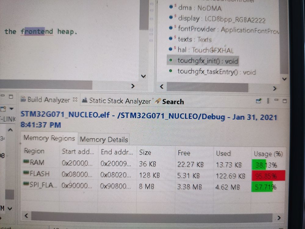

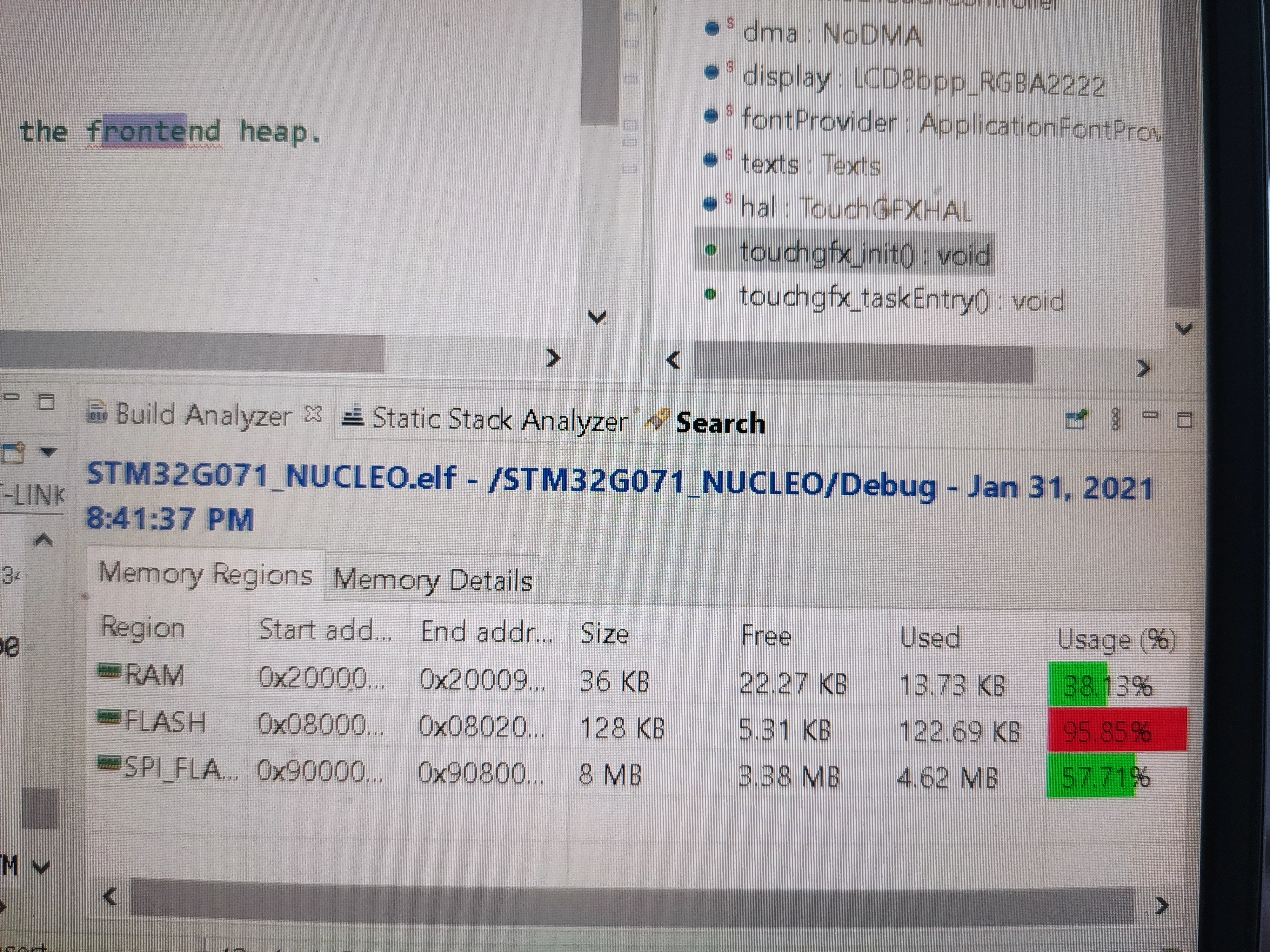

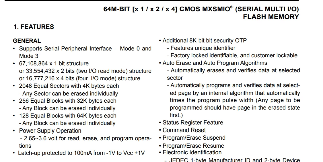

Hello MM , Thanks for your reply
Let me reformulate the problem :
if the compiled extflash.bin is over a certain size (typically over 4MB) the external flash loader provided by ST for this demo board (GFX01M1 + STM32G071 Nucleo board ) fails to load this file to external flash .
Actually i tried several times using different boards and it always fails at verification step @ address 0x90400000, according to linker script this is in ext flash area and it correspond to a size of 4,194,304 byte which should still fit in that flash chip used (MX25L6433FM2I-08G 64-Mbit SPI NOR Flash ) so there is plenty of space left ...
 i tried different ALIGN options in linker script for ExtFlashSection & FontFlashSection : 2 , 4 , 8 , 16 , 32 but no effect is observed . for some raison the flashing process of external memory always fails @ 0x90400000 this is quit frustrating.
ps : i'm using GFX01M1 + STM32G071 Nucleo so all BSP drivers are provided by st (lcd , ext flash , buttons ....)

I'm using MX25L6433F_STM32G071B_NUCLEO.stldr which is the appropriate flash loader for this demo board , it's not about .bin or .hex it's a bug in the flash loader itself and since we don't have access to source code this require someone from ST to intervein which i would highly appreciate since this post has over 2 days !!!.
BTW : compiled extflash.bin is around 4.8MB so its not an overflow problem .

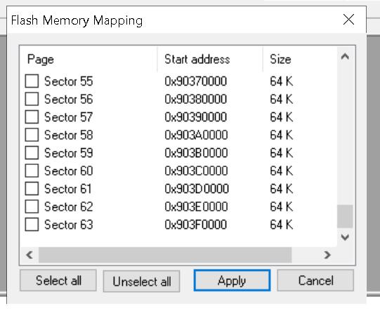

AAnis.1
AAnis.1Author
February 2, 2021
UPDATE:
when using STlink utility allong with the appropriate flash loader , when it come to sectors erase it only shows 64 sectors of 64KB each or this is just half of NOR chip capacity (8MB) , datasheet says it has 128 sectors of 64kB each , hmmm i guess that the flash loader is bugged0693W000007DfuYQAS.png0693W000007DfuJQAS.png
ANY suggestions STM team ???
