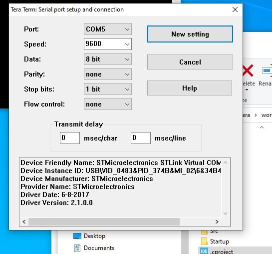

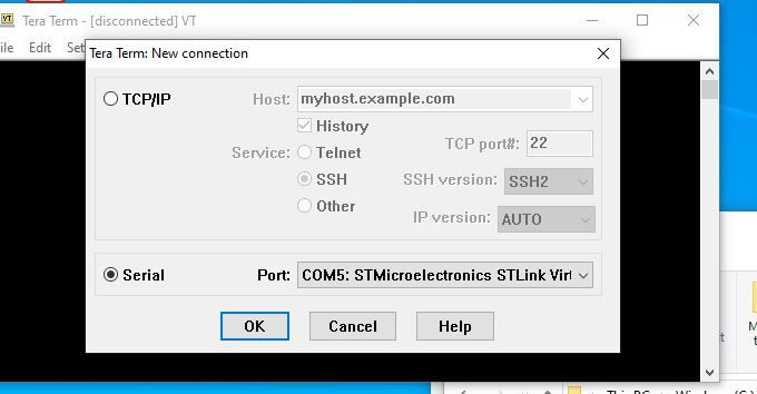

Hi, I'm in the process of going through the labs in part 4 of the ST Security MOOCs, specifically the hands on over here .
https://www.youtube.com/watch?v=0CVplWZ8zls&list=PLnMKNibPkDnF0wt-ZI74SflnsBV4yKzkO&index=3
The hands on asks to connect a terminal to the board in order to receive some output from the app running on a Nucleo G071RB board. I am not, however, able to see any output, any ideas as to why that is? My Tera term configuration is given below, thanks! Upon reset I just get garbage printed to the screen as depicted in the 3rd screen shot below

waclawek.jan
Probably baudrate mismatch.
Try other baudrates in TeraTerm.
Observe the UART's Tx signal using oscilloscope/logic analyzer.
Review the clocks setting in STM32 (read out and check relevant RCC registers' content) and also check the given UART's baudrate setting.
