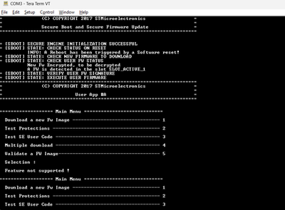

I'm currently working on a project using the STM32WB55 MCU and am in the process of implementing Secure Boot and Secure Firmware Update (SBSFU) in my custom application. As part of this, I decided to test the existing 1_Image_SBSFU example before integrating it into my application. However, I'm encountering some issues and would appreciate your guidance.
Issues Encountered:
Application Not Working:
STM32WB Board Access Issue:
Can anyone provide a step-by-step guide on how to properly test this firmware? Are there any specific configurations or steps that I might be missing?
What steps should I take to regain access to my STM32WB board via ST-Link for further debugging?
Any help or suggestions would be greatly appreciated. Thank you in advance for your support!

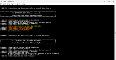

Hi ST team,
- The bootloader appears to be functioning correctly. I can see the STM_OTA device in the ST BLE sensor mobile application.
- When attempting to perform an OTA update using the my application file, it results in an error.
I have successfully build my application compatible with SBSFU and after OTA, basic functionality is working but BLE is not working.
The same firmware worked earlier without an issue and BLE stopped working only after integrating SBSFU changes in firmware.
Can you please guide me to fix this issue?
Also What steps should I take to regain access to my STM32WB board via ST-Link for further debugging?

Hi @STTwo-32 ,
I know that CPU2 is fully initialized when the static void APPE_SysEvtReadyProcessing( void * pPayload ) function reaches to the stack. If this condition (p_sys_ready_event->sysevt_ready_rsp == WIRELESS_FW_RUNNING) is met, I know CPU2 is good to go.
My firmware keeps waiting until CPU2 is fully initialized to start it's other routines that are dependent of BLE and other shared resources with CPU2.
What happens is that this function is not called in my firmware it keeps waiting for this.
Can you please help me to fix this issue ?
