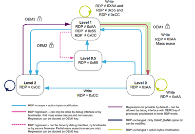

STea
Hello @Surya S and welcome to ST Community ,
Note that unlocking the device with a password is only possible once per power cycle.
more details can be found on this in this article and this presentation .
BR
Your article link doesn't work...
Hello @Piranha ,
Indeed the link does not work because it's under maintenance here's the block diagram that i wanted to refer to :
the same information could be found in details in RM 0456 section 3.10.1 Life-cycle management with readout protection (RDP).
BR
