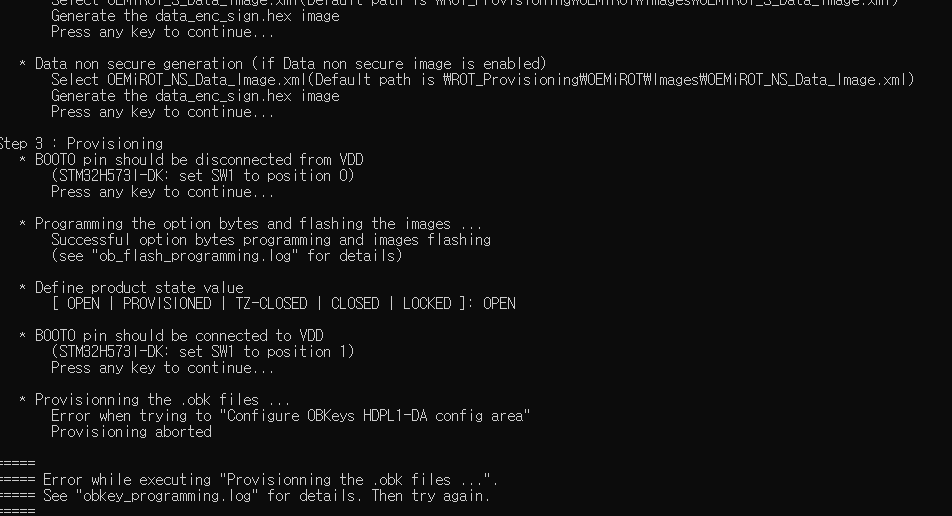

I'm using a STM32H573-DK board for engineering samples.
so. I'm run a example this link but provisioning.bat files does not run at 'Step 3 : Provisioning'
How to fix this problem?

attach obkey_programming.log file contents

Secure Data Provisioning Start. OBK Input file : ../DA/Binary/DA_Config.obk
Error: Execution of RSS CMD fail with timeout
Error: call_RSSLIB_SetOBKey Failed

‎2023-12-18 11:47 PM - edited ‎2023-12-19 12:59 AM
insure to change SW has indicate in the trace and then it should works

‎2023-12-19 4:08 AM
Hello LEFRERE.
how to change SW?
Can i see trace and working SW, if i change SW?
‎2023-12-19 4:12 AM - edited ‎2023-12-19 4:12 AM
This is a material switch on your board, bottom left not far from RESET. Thre is a serigraphy : BOOT0
‎2023-12-20 4:39 PM
Yes, my board SW1 already set to FLASH (0)
‎2023-12-20 5:06 PM
Sorry solved problems, first SW1 set a position 0 and next set 1 finaly set 0.
These processes have not been performed.
