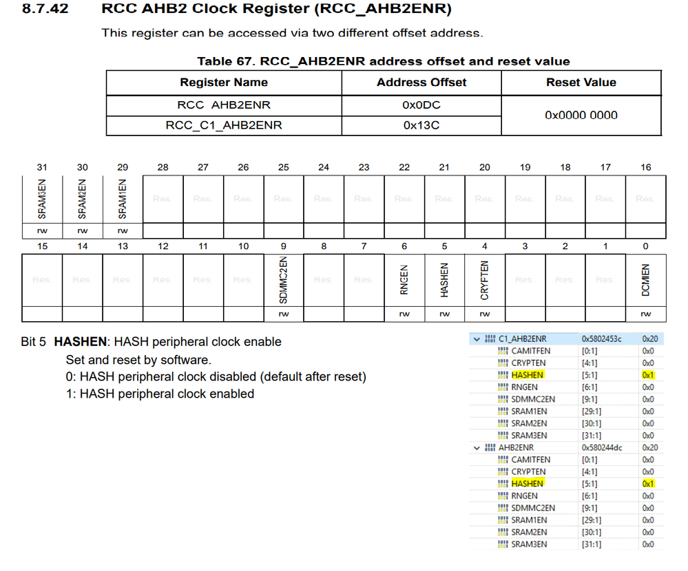

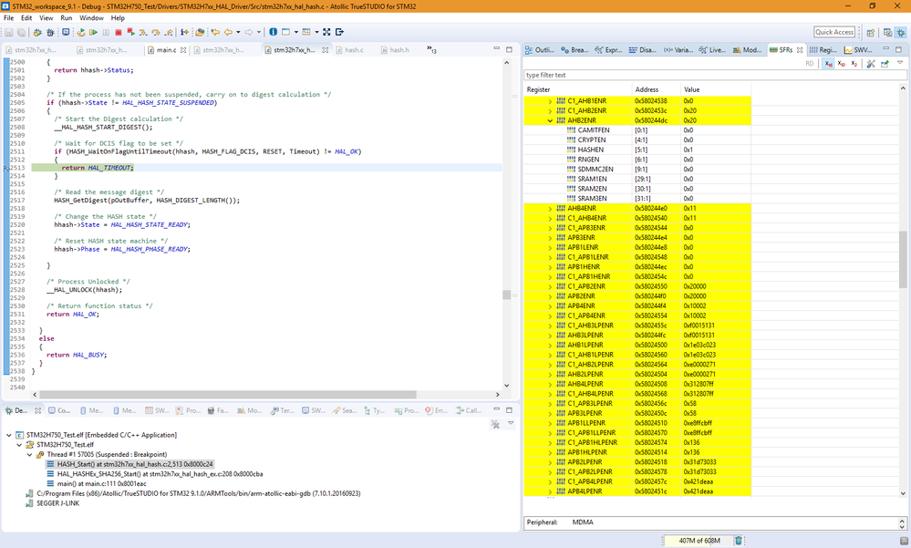

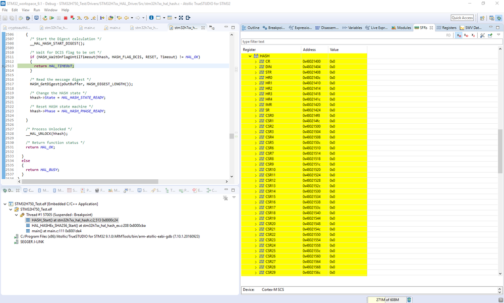

I created a new basic project for testing this issue and the code is as shown. However, HAL_HASHEx_SHA256_Start() always ended up returning HAL_TIMEOUT. Based on the SFR register view in Atollic TrueSTUDIO, all the registers for hash peripheral remains at value 0x0.

- Directly editing the registers values in SFR register view shows illegal input while bit editing has no effect. (*There isn't any issue editing other peripheral registers for example SysTick SYST_CSR*)
- Checked RCC_AHB2ENR HASHEN bit is enabled indicating the clock to hash peripheral is enabled.
