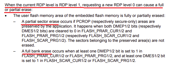

1- There is no official reference or recommended TRACE32 PRACTICE (.cmm) script provided by ST.
2- Please refer to the knowledge base article: How to change the Read Out Protection on STM32H7

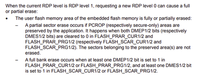

3- The RDP regression from level 1 to level 0 the mass erase is automatically performed by hardware. This is the condition described in the reference manual RM0399:
Hope that helps.

@Firmsol wrote:
The article  How to change the Read Out Protection on STM32H7 demonstrates RDP level changes using the CLI‑based STM32CubeProgrammer, which is not applicable in my case.
I think you didn't read the article carefully. Please read again the section 3. Coding
@Firmsol wrote:
4) When mass erase is issued, whole flash memory will be erased?
As stated in my previous post, that question has been answered in this section in the reference manual:
If you need an explanation of that section you need to open a new post because that's a new question and close this one.
