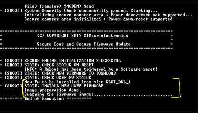

Hi @Jocelyn RICARD,
I'm using the example under Projects -> STM32H750B-DK -> Applications -> 2_Images_ExtFlash from the  stm32cube-expansion-sbsfu-v2.6.2 software archive available from your site. I'm also using Tera Term to connect to the STM32H750B-DK dev board and check the secure boot behavior by the outputs from the board there.
Taking another look at the output, I now think the board is properly rejecting the image with the corrupted header, but an error message specific to that case isn't being displayed. When I load a valid FW image, I get this message saying the new FW needs to be installed, and then it is swapped into the active slot:

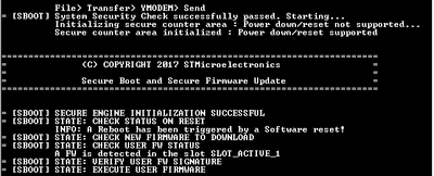

However, when I try to load the image with the corrupted header (any single bit flipped before byte 1024), I get this message that does not contain any lines indicating the image is being installed or swapped:
It seems that in this second case, the SBSFU detects the corrupted header and rejects it, but does not output a message about the header being invalid. It then goes on to execute the existing valid FW in the active slot. Is my interpretation correct? And would you expect there to be a message about the header or no?

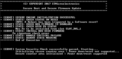

I expected there to be an error message about the header because when I corrupt the firmware image past the header (byte 1024) and try to load it I get a "Fw signature check error" message, and then the already loaded and valid program is executed:
Hello @SebastianAdams ,
Thank you for the details. Fortunately no big issue !
The best way to make sure your firmware is well updated is to change something visible and possibly firmware version.
As I described earlier, the first step is to check the signature of the header. Then if OK, check the hash of the firmware comparing with the hash provided in the header content.
Also, a version check is done. Lower versions are rejected.
It looks like a message is missing relative to the header signature checking failure. I will raise this point.
Now you understand how things work, a good exercise is to add this message :)
