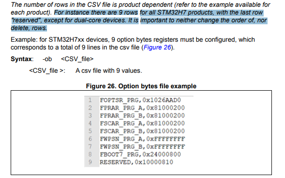

STM32 Trusted Package Creator v2.12.0 creates incorrect option bytes
2023-01-25 9:51 PM
STM32 Trusted Package Creator v2.12.0 creates incorrect option bytes which have 8 rows and no "reserved" last row
As per AN5054, it should have exactly 9 rows
The option bytes csv created from STPC v2.12
This leads to SFI programming failure. Am I missing something here? or there is a bug in exporting option bytes using STPC

Hi @Community member,
Yes, I see the discrepancy between the AN and the actual tool output. I asked the tools team for explanation.
Thanks for reporting the issue!
