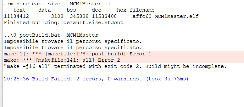

Hi Dfarr.1, I can't build with your code, see picture:
_legacyfs_online_stmicro_images_0693W00000bkxwxQAA.pngimpossible to find path.
_legacyfs_online_stmicro_images_0693W00000bkxx2QAA.pngas you can see, this the place where the file are included, and the srec path.
can you help for this? thanks.
Solved, the problem was in a missed #. The code work perfectli flowless... very thanks for this help....
