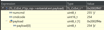

During debugging I also stumbled upon this:

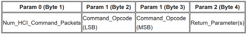

An HCI command complete packet should have the following format:
But the command opcode fields do not reflect the opcode of SHCI_OPCODE_C2_REINIT (0xFC6F), but are instead set to the returned error code (254 / 0xFE, coincidence?):
(this is taken on the return line of SHCI_C2_Reinit in shci.c)
For other commands (checked SHCI_C2_FUS_LockUsrKey and SHCI_C2_FUS_GetState) the cmdcode field is set correctly.
Is there a problem with the SHIC_C2_Reinit command? Is it somehow an expected behaviour (but why then is __SEV() during application/loader C2 init not working?)

​Hello,
I am not sure of the working flow you need to implement but I believe the issue is that you are sending the SHCI_C2_Reinit() comand to the FUS. However, only the wireless firmware is supporting that command so the FUS should just report it does not support that comamnd.
If the plan is to jump from the SBSFU to the BLE Loader, it means it expects to load a wireless update firmware over OTA and this is not possible when the FUS is running on CPU2. You need the wireless firmware running on CPU2 for this.
The expecting working flow is that the SBSFU jumps on the BLE Loader only when the CPU2 runs the wireless firmware. If the FUS is running on CPU2, it measn a wireless update has been dowloaded and needs to be install and that is the responsibility of the SBSFU to complete the installation.
Is there any reason why the CPU2 is running the FUS when you are getting out from the SBSFU ?

​Hello,
SHCI_C2_FUS_*  are clearly NOT supported by the wireless stack except :
FUS_GET_STATE which is used to request the wireless firmware to switch on the FUS when called twice
and all SHCI_C2_FUS_*** related to Customer Key Storage (CKS) feature.
For all command related to CPU2 firmware update, you need the FUS running on CPU2
