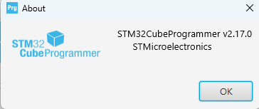

- can you share with us a screenshot of the problem visualized with cube programmer and mention the version you are using to try and fix this error message

Hello @tstokes ,
can you check the version of cubeProgrammer that you are currently using?
