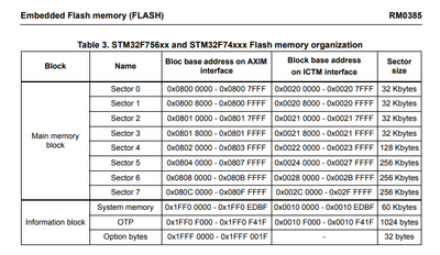

I have a question about possibility of splitting/dividing FLASH sector for active/download image slots.
A bit more context... My target MCU is STM32F756ZGTx, here is its FLASH memory map:
What we want to do is: assign sector 4 (128 kB) and sector 5 (256 kB) as a download image slot; assign sector 6 (256 kB) and half of sector 7 (1/2 * 256 kB = 128 kB) as an active image slot.
My question is: can we do that?
As far as I understand, SWAP and active/download slots should be aligned with FLASH sectors, so the answer would be "NO", but maybe I'm wrong.
Thank in advance!

What's going in the other half of sector 7? If nothing, then maybe it could work out.
When the firmware needs to update, it will erase the entire sector and you'll lose whatever is on the other half of it, since you can't erase only half of it.
‎2023-09-13 8:32 AM
Rest of that sector would stay empty/unused.

Sector 4 + 5 are used for download, I don't divide them i.e., download slot starts with sector 4 and end ups with sector 5. On the other hand, active image slot uses whole sector 6 and 1/2 of sector 7.
To my surprise this works fine. Now I have other problem with the SWAP area which is placed under sector 3. In short I am unable to either download new image to empty slot (i.e., only SBSFU is installed and I'm trying to upload UserApp) or swap image stored in download with active one (assuming that SBFU is installed with UserApp at once at the very beginning).
‎2023-09-19 5:14 AM
Small update on that topic. Looks like dividing Flash sector (i.e. using only half of it) doesn't work as I thought.
SBSFU starts up completely fine, but when it comes to swapping the image, which includes erasing FLASH sectors, it breaks during FLASH erasure. My suspicion comes to the fact, that FLASH sectors must be erased "fully" as a whole i.e., if FLASH sector is of 256 kB size, one cannot just erase half of it.
I can be completely wrong, so if anyone has better knowledge please let me know.
PS. When I've switched to full sectors instead of full sector + 1/2 of another one, it has started working fine or at least FLASH erasure part works fine. In other words, SBSFU erases FLASH for new download image successfully and then it downloads new image properly. Unfortunately it still breaks on swapping procedure. That might be related with the fact, that we put SWAP area where normally SBSFU resides (MPU protection is turned off if anybody wants to ask).
