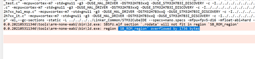

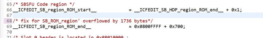

Then started building projects, run into overflow error
0693W00000HoyKiQAJ.pngFixed it by referring to section 6.2 Memory mapping adaptation

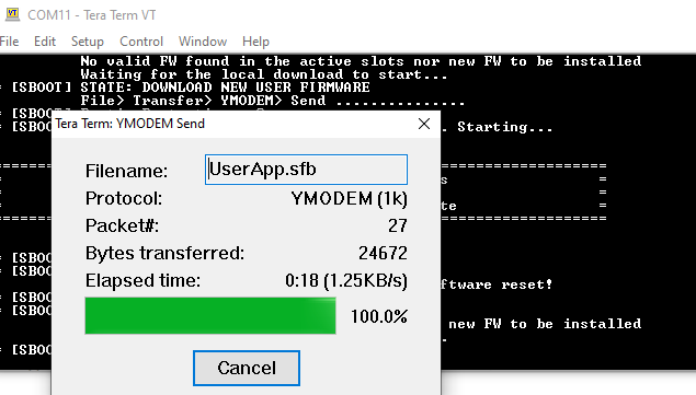

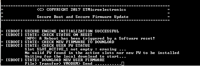

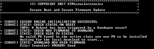

6 SBSFU executing
7 User application send to device
Now instead of actually jumping to application SBSFU is still waiting for UserApp :pensive_face:

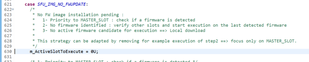

In sfu_boot.c control is returning from
Hoping to get some pointer on what is going wrong in system.

On STM32H7B3 the flash sector size is 8KB.
So, when you extend the size of one element it is better to align on this.
Also, of you extend the SBSFU memory size by 8KB you will need to move the first slot in mapping_fwimg.ld
So, if you add 8KB to SBSFU you will start 8KB further
__ICFEDIT_SLOT_Active_1_start__ = 0x08010000;
should be changed in
__ICFEDIT_SLOT_Active_1_start__ = 0x08010000 + 0x2000;
Other point to be aware of, which is related to the comment in mapping_sbsfu.ld
/* Aligned SBSFU end at the end of the 1st 64Kbytes of FLASH, MPU protection constraints */
As this alignment is no more respected, the MPU configuration will need to be adapted.
MPU configuration for this part is MPU region 3.
One way to setup is to set MPU region 128KB and but use only first 5 subregions.
1 subregion size for 128KB is 16KB (16*8=128)
So, you would need to allocate 16KB more for SBSFU instead of 8KB.
This results in:
__ICFEDIT_SB_region_ROM_end__       = 0x0803FFFF;
__ICFEDIT_SLOT_Active_1_start__ = 0x08010000 + 0x4000;
And then MPU configuration
#define SFU_PROTECT_MPU_FLASHEXE_SIZE MPU_REGION_SIZE_128KB
#define SFU_PROTECT_MPU_FLASHEXE_SREG 0xE0U
0xE0 means you exclude the 3 last subregions (this is a bit field)
I hope this will help
Best regards
Jocelyn

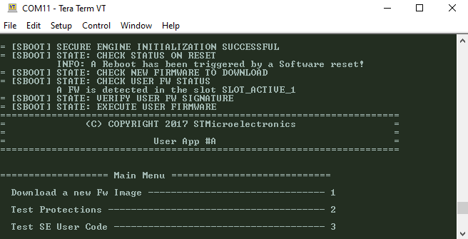

Thanks @Jocelyn RICARD​ for detailed and complete instructions on
  • Application offset to accommodate increase in SBU size.
  • SBU alignment requirement
  • MPU configuration
:thumbs_up:
BL is transferring control to application code
