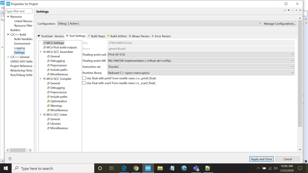

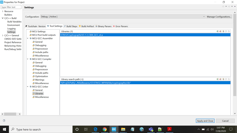

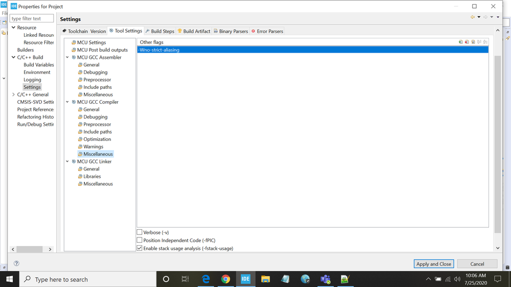

 For more information please check attached screenshots
1. Right click on your project and select properties
2. Select Settings under C/C++ Build
3. Select Tool Settings
4. Go to Libraries tab under MCU GCC Linker
  Add following path
  a. => :STM32CryptographicV3.1.3_CM4_GCC_ot.a under Libraries
  b. => "${ProjDirPath}/../Middlewares/ST/STM32_WPAN/ble/cryptographic/Lib"
      under Library search path
6. Go to Miscellaneous tab under MCU GCC Compiler
  Add following flag
  -Wno-strict-aliasing

  a. => Floating-Point ABK - Mix HW/SW implementation
8. Go to include paths under MCU GCC compiler and add following path

when changing the library to the …GCC_ot.a, CubeIDE requires the FPU to be a mix for the crypto lib.
