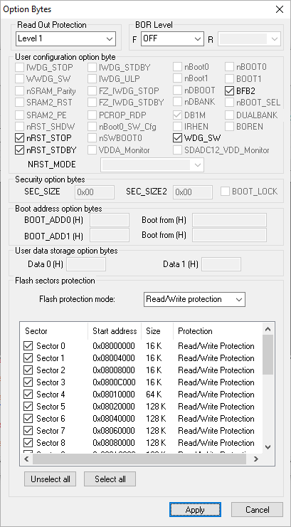

Hi, I have the STM32F427VI, I don't know how this happend but now is read/write protected Level1. How can I reset this, I want to disable read protection at all to burn my application.
Now I can't read the memory with STM Utility with J-TAG and coudn't erase memory with Demonstrator GUI via RS232. Please see the attached image.

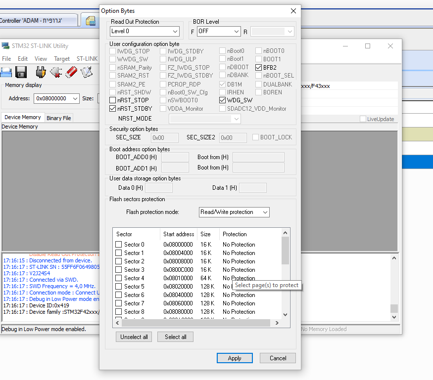

Uncheck all sectors on the bottom and change Read Out Protection in the top-left to Level 0 and apply.
‎2020-06-11 7:20 AM
I tried this but I get the error: Could not set Option bytes!
Please see the attached picture. Thank you for your help:)

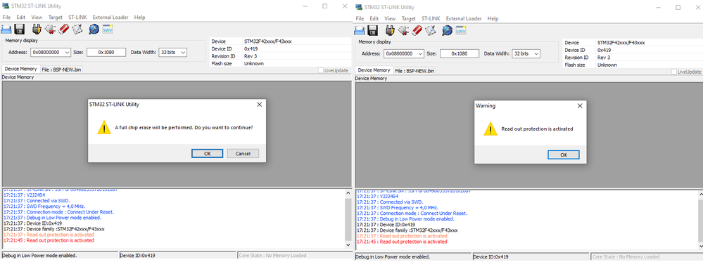

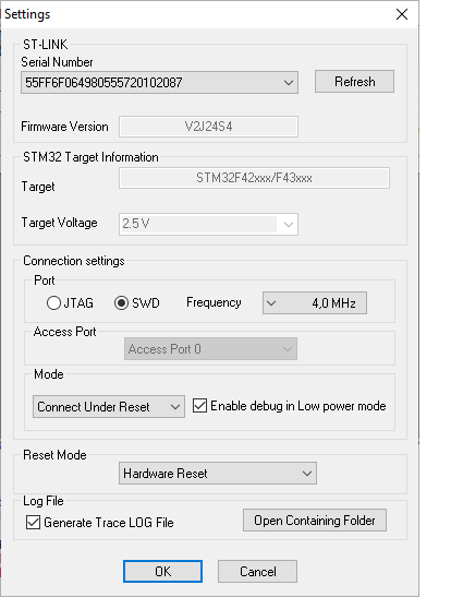

Set "Connect Under Reset" and do full chip erase.
‎2020-06-15 7:24 AM
This is not working. Please see the images attached

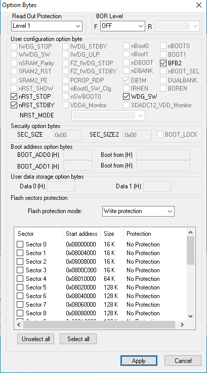

‎2020-06-15 7:34 AM
I managed with the option bytes to remove the read only but when I conenct with JTAG I still get the message that the MCU is ready only
‎2020-06-15 7:42 AM
I managed to do it by removing all jumpers in the board.Thanks!
