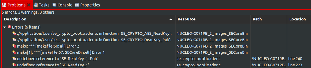

Hello everyone,
I am trying to build SECoreBin, but the build fails with prebuild.sh. All python requirements listed in requirements.txt are installed, but the error is following:
ImportError: No module named Cryptodome.Cipher
And even more:
What should I do? As I have said, cryptodome is installed.
Thank you, Jocelyn. I've checked the version and these were different (python3 required, but python2 was called). I have changed the default python version to 3.8 and it worked. (I am working under ubuntu).

Hello @leeana​
Which platform are you using ?
Can you make sure that the python version launched by STM32CubeIDE is the same you updated with pip?
Best regards
Jocelyn
