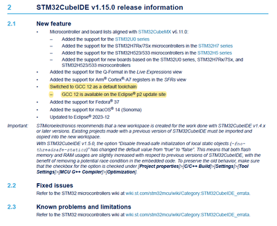

Can you check with the new STM32CubeIDE version 1.15, it integrates the GCC 12 as default toolchain, newlib-4.2.0
