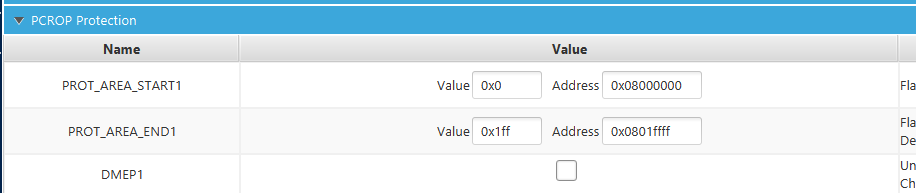

Hello @Onizuka09,
Ok, I'll make this change and hope it works for PCROP by setting DMEP for both registers.
My question is, after setting PCROP for that memory area from 0x08000000 to 0x08020000, does the software for this area still start working for the user during RDP regression?
hello @Domy_ST
After setting PCROP for your desired memory area and ensuring both DMEP bits are cleared, the software in that area will continue to execute for the user during and after RDP regression. Only instruction fetches are allowed; all other access types are blocked, maintaining the security of your proprietary code.
the workflow to configure PCROP region:
  1. Define a dedicated executable section in the linker script.
  2. Place the code you want to protect into that section.
  3. Compile with the required flag: -mslow-flash-data
  4. Program the firmware.
  5. Activate the PCROP region using the flash protection configuration (STM32CubeProgrammer).
  6. make sure the DMEP bit is configured to 0 (unchecked)
PCROP Activation Rules
  • If START > END, PCROP is deactivated
  • If START < END, PCROP is activated
I would sugget to you to take a look at these references:
  • Security Part 3: STM32 security features MOOC: link
  • ST provides an expansion package for PCROP (X-CUBE_PCROP): link
B.R
Hello @Onizuka09,
Thanks for the valuable support. I'll try to get it to work on STM32H755, otherwise I have no other options.
ciao @Onizuka09,
I tried setting up pcrop with DMEP = 0 for both registers, but I don't see the software running for that area protected by pcrop for the user.
The software simply prints a character string with printf, so you can see via serial that the software should run by printing strings... while without pcrop protection, the software runs.
Helllo @Domy_ST
Could you share a few more details to help narrow this down?
  • the PCROP address range
  • whether any fault handler is triggered
  • the linkerfile setup and how did you setup the region of PCROP
B.R
hello @Onizuka09,
I apologize for replying now.
I'll try to explain how I set up PCROP below:
first I download the Bootloader SW (I modified the code so that inside the While there is only the printf of a string like "hi you are inside the bootloader with PCROP Active") and then I enable the PCROP in the range 0x08000000 - 0x0801ffff and DMEP = 0, so only the first sector of 128KB as in the image below
once PCROP is activated for that address region it no longer prints the aforementioned string.
Excuse my ignorance, what do you mean by error handler? Perhaps you mean how I defined error handling in the bootloader SW code. I defined it this way:
void Error_Handler(void)
  __disable_irq();
  while (1)
I also couldn't find/create this linker file question. Is it in the project code? Can you tell me which file it is and how to define it?
Thanks for your valuable help.
