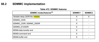

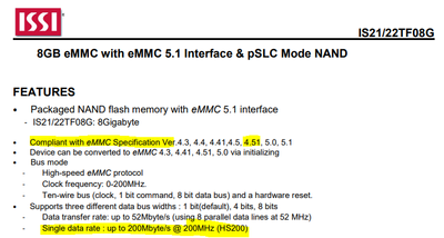

In the RM0399 58.1 it is mentioned that EMMC is supported up to Version 4.51. I want to use the part  IS22TF08G-JCLA2 which supports a number of emmc interfaces up to 5.1 are these parts compatible?

The HS200 mode supported in IS22TF08G is compatible with STM32H755.
Thank you.

Hello @sarun ,
Thank you.
Kaouthar
