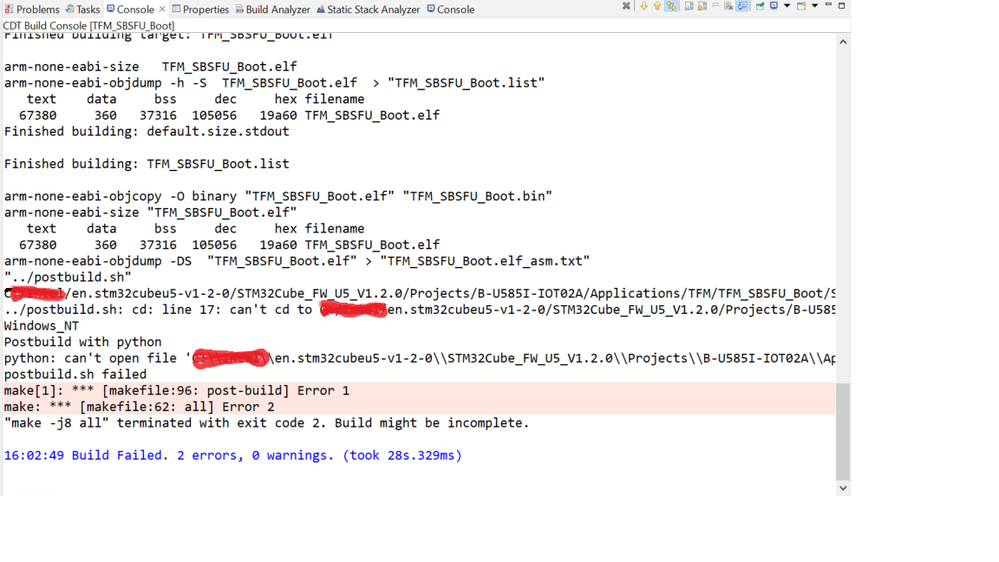

HI All
First of all i would like to thank ST Team for providing an update on the TFM Package. I downloaded the package and am trying to build the TFM SBSFU Package with the following prerequisites
  1. python installed
  2. pip with requirements also installed(requirements.txt)
  3. python added in environment variable
  4. installed imgtool from python script
(these are taken from the readme document)
When i build the tfm-sbsfu program from stmcube ide i am getting 2 errors.
  1. can't cd to the path \..\..\..\..Middleware\Third_Party\mcuboot: no file or directory
  2. No File found - \..\..\..\imgtool\main,py: no such file
I verified the directories mentioned the 2 errors and found the files were present. due to this the postbuild.sh script is failing. (Attaching the error screenshot for reference).
I request help from the channel to know if i have missed anything.
I am refering to the readme files and UM2851- Reference Manual
Kindly assist me
Thanks in advance
Guillaume K
Hello
is there a space character in the path where STM32Cube_FW_U5_V1.2.0 is installed ?
if yes, try to install it in a path where there is no space, or use DOS subst command to create a new drive letter from STM32Cube_FW_U5_V1.2.0\ and load the project from this drive (in STM32CubeIDE).
