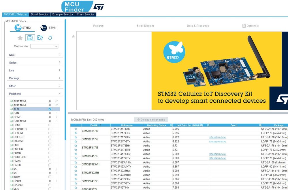

Hello @OISLE​ and welcome to the Community :)
There is a large selection which may answer your request.

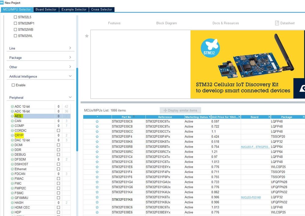

I recommend you to use the "MCU Finder" tool (mobile version, PC version) or the one integrated in STM32CubeMX, to fine tune your choice based on multiple criteria and select the suitable one(s).
You can also compare MCU/MPU characteristics using "Cross selector" feature.
Regarding STM32F410 it's doesn't contain cryptographic functions.
I recommend you to refer to the product Datasheet to have more idea about the product features and IPs characteristics.

Alsa I don't have CRYP in list..
