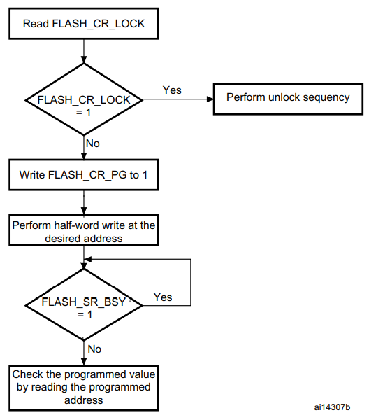

Hello.
I'm trying to program the main flash memory of STM32F103RCT6 using J-Link while RDP is enabled.
I followed main flash memory programming procedure in PM0075 manual.
the procedure is in below picture.
When only RDP is enabled, I unlocked Flash_CR_LOCK bit and then Write FLASH_CR_PG to 1.
After this procedure, I tried to write half-word data to 0x080069f0.
However, J-Link reports the error like this.
****** Error: Timeout while calculating CRC, RAMCode did not respond in time. (PC = 0x00000000, CPSR = 0x00000000, LR = 0x01000000)!Failed to erase sectors 14 @ address 0x08006800 ((erase error))
Failed to erase sectors.
Is it impossible to program main flash memory when RDP is enabled?
If not, how can I do it?

‎2021-07-08 1:35 AM
Reset the option bits to default, meaning no protection. Mass erase of flash happens as result of the RDP downgrade. Then proceed as normal.
‎2021-07-08 3:05 AM
Hello, Thank you for your answer.
However, I want to try programming 2 bytes of main flash memory when RDP is enabled not resetting the device.
Thank you
‎2021-07-08 3:21 AM
Carefully read pm0075:
Once the protection byte has been programmed:
Pages 0-3 (for low- and medium-density devices), or pages 0-1 (for high-density and
connectivity line devices) are automatically write-protected. The rest of the memory can
be programmed by the code executed from the main Flash memory (for IAP, constant
storage, etc.), but it is protected against write/erase (but not against mass erase) in
debug mode or when booting from the embedded SRAM.
