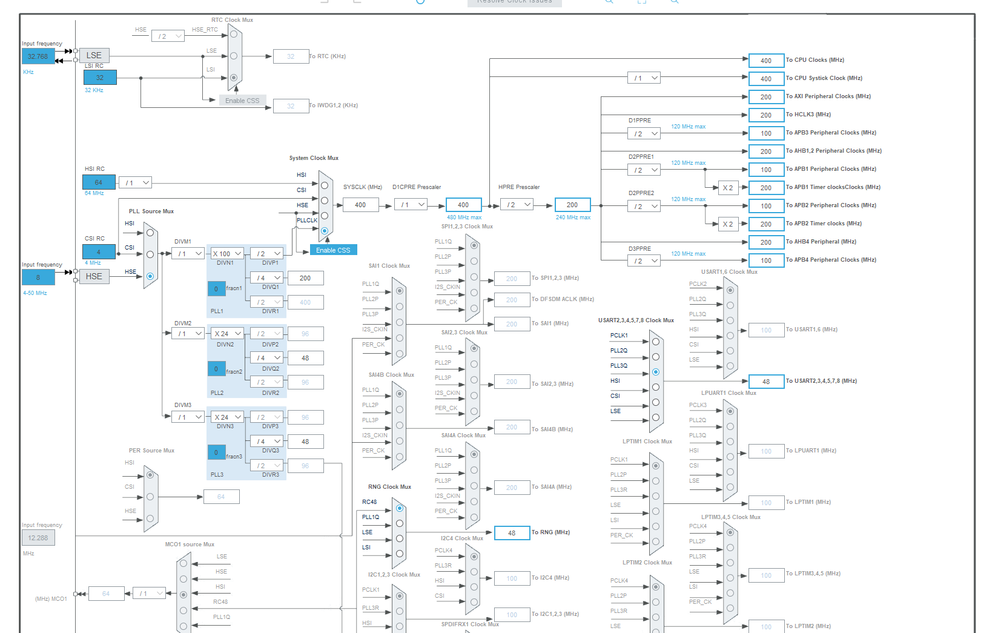

I would like to use the RNG of the H743ZI2. The provided example works, but on a new project I can't get it work, The CPU clock is configured to 400MHz just like in the example.
/* RNG Initialization */
if (HAL_RNG_DeInit(&hrng) != HAL_OK)
 /* DeInitialization Error */
 Error_Handler();
/* Initialize the RNG peripheral */
if (HAL_RNG_Init(&hrng) != HAL_OK)
 /* Initialization Error */
 Error_Handler();
uint32_t rnd_number;
void main()
 while (1)
 status = HAL_RNG_GenerateRandomNumber(&hrng, &rnd_number);
 if (status != HAL_OK)
 Error_Handler();

0693W000007DjFQQA0.pngHello Imen,
I'm currently debugging the problem. The RNGEN isn't set. Even writing directly to the register doesen't change any bits in it.
At the moment it "smells" like there is something wrong with the clock configuration. I attached a screenshot of the current clock configuration.

In the example, there is one line:
 /*## Configure the RNG peripheral #######################################*/
 RngHandle.Instance = RNG;
/* DeInitialize the RNG peripheral */
 if (HAL_RNG_DeInit(&RngHandle) != HAL_OK)
 Error_Handler();
which I missed copying and totally overread later. Thats the line where the handle is asserted. When missing, the driver doesen't notice the invalid handle.
