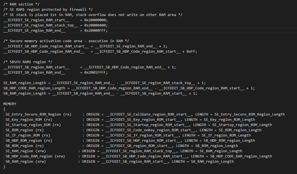

Ikbal
Hello @Jocelyn RICARD​,
I have added the STM32CubeExpansion_Crypto_V4.0.1 library in the SBSFU application for STM32H7B3I-DK example application.
I have change the Image header verification API from ECDSA verification to RSA 2048 verification. I have successfully tested the RSA verification API using example application of STM32CubeExpansion_Crypto_V4.0.1 for STM32H7B3I-DK.
After adding the STM32CubeExpansion_Crypto_V4.0.1 in the SBSFU, I am getting the below compilation error during SE_CoreBin application compilation.

arm-none-eabi-gcc -o "SECoreBin.elf" @"objects.list"  -l:libSTM32Cryptographic_CM7.a -l:STM32CryptographicV3.1.3_CM7_GCC.a -mcpu=cortex-m7 -T"../STM32H7B3LIHxQ.ld" --specs=nosys.specs -Wl,-Map="SECoreBin.map" -Wl,--gc-sections -static -L"C:\ST\STM32CubeExpansion_SBSFU_V2.6.1\Middlewares\ST\STM32CubeExpansion_Crypto_V4.0.1\Middlewares\ST\STM32_Cryptographic\lib" -L"C:\ST\STM32CubeExpansion_SBSFU_V2.6.1\Middlewares\ST\STM32_Cryptographic\Fw_Crypto\STM32H7A3\Lib" -L ../../../Linker_Common/STM32CubeIDE --specs=nano.specs -mfpu=fpv5-d16 -mfloat-abi=softfp -mthumb -Wl,--start-group -lc -lm -Wl,--end-group
c:\st\stm32cubeide_1.10.1\stm32cubeide\plugins\com.st.stm32cube.ide.mcu.externaltools.gnu-tools-for-stm32.10.3-2021.10.win32_1.0.0.202111181127\tools\arm-none-eabi\bin\ld.exe: SECoreBin.elf section `.bss' will not fit in region `SE_RAM_region'
c:\st\stm32cubeide_1.10.1\stm32cubeide\plugins\com.st.stm32cube.ide.mcu.externaltools.gnu-tools-for-stm32.10.3-2021.10.win32_1.0.0.202111181127\tools\arm-none-eabi\bin\ld.exe: region `SE_RAM_region' overflowed by 4256 bytes
collect2.exe: error: ld returned 1 exit status
make[1]: *** [makefile:69: SECoreBin.elf] Error 1
make: *** [makefile:62: all] Error 2
"make all" terminated with exit code 2. Build might be incomplete.
I have attached the SBSFU LD file for RAM memory definition:
Please help to fix this error.

Jocelyn RICARD
Hello @Ikbal​,
as error message says: "`.bss' will not fit in region `SE_RAM_region'"
In your implementation, you seem to have created new non initialised buffer, that do not fit any more to the RAM allocated to the SE.
So, you first need to check if this all this new memory is necessary (maybe you left old unused buffers).
Then, when you are sure about your implementation, you can increase the RAM allocated to SE in the linker file that is the SE_RAM_Region.
Best regards
Jocelyn
