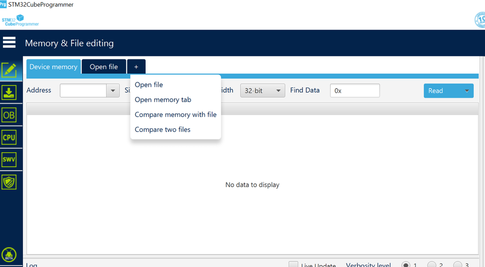

Flash writing procedure has just finished. The next step, anyone can assume, is verification, that code has been written correctly, which involves reading the flashed memory. At this stage, if I trace the API calls, which Cube tool does to perform flash reading. Does this mean I can copy the firmware without having vendor keys? Please point me at which step I'm wrong.

If you want to verify that your code has been written correctly on your MCU, I would recommend to use STM32CubeProgrammer.
In the "Memory & File editing" tab click on "+" and "Compare memory with file" , then select your .hex or .bin file to compare with the internal memory  .

My actual concern is how Cube does this compare operation. It reads internal flash (by some portions) which is decrypted, and then compared with decrypted binary? So, if I have the tool, which would record the calls/messages Cube sends to do this, I can then repeat them in my own code and obtain the firmware in internal flash? How internal flash can be protected against that?

But if I trace the calls Cube does to perform verification, I can repeat them in my own tool, and using another device I can get the firmware? Is there any protection against that?
Also please see the above picture, how memory comparison works, after memory is protected?
Hi @VTver.1​ ,
Sorry I misunderstood your concern, if you want to protect your internal code on U5 devices, you can used the key security features on U5 devices :
  • Debug protection, depending on the RDP level
  • Optional password-based RDP level regressions, including for RDP level 2
  • Protected firmware distribution scheme, using TrustZone, on-the-fly decryption, and RDP level 0.5
  • Active tamper and protection against temperature, voltage and frequency attacks
Please refer to the section 3 "System security" on the attached reference manual.
A.MVE
@VTver.1​ , once protected your firmware won't be accessible even by STMCubeProgrammer. The picture above works only if the device is not protected
