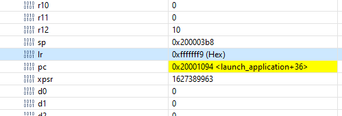

Value of LR,SP

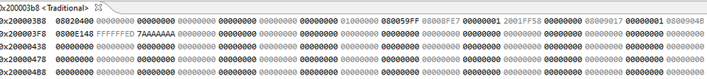

Memory of stack pointer : 0693W00000HqonyQAB.png
2) LR : 0xFFFF.FFF9 return from Handler mode so NVIC does unstacks PC, R0-R3, R12, LR, xPSR
PC : 0x8020400 looks correct for APP launch

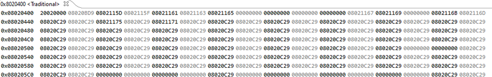

3) Application memory at 0x8020400
0693W00000HqopGQAR.pngWhich also looks about right.

My bad the bootloader is actually making a jump to the application. UART configuration of application(Sample application) is corrupted somehow when it transfers control and its not printing the data.
Closing the ticket
